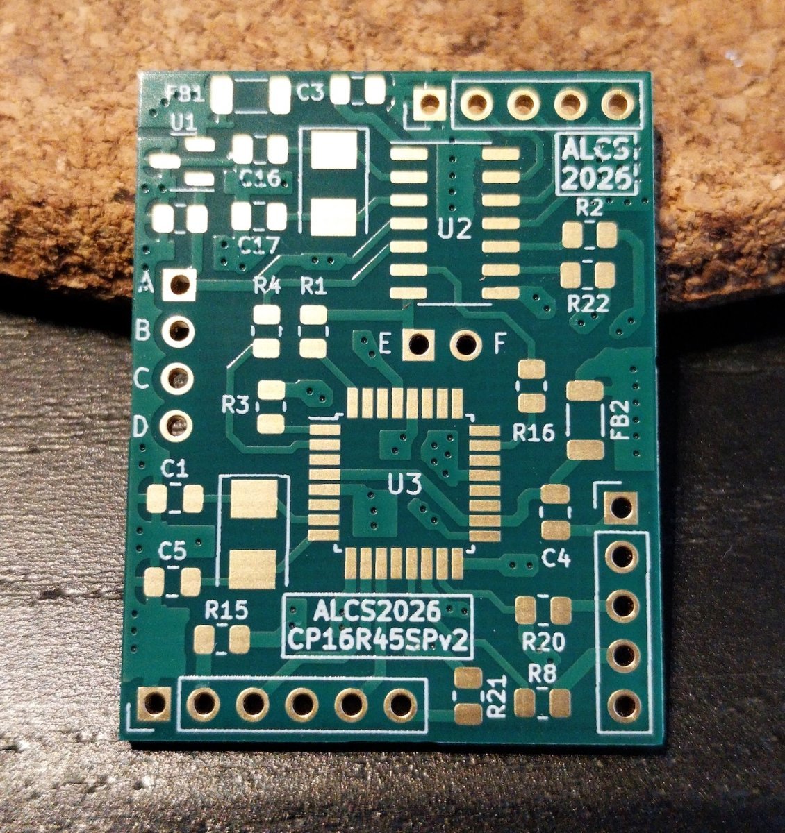

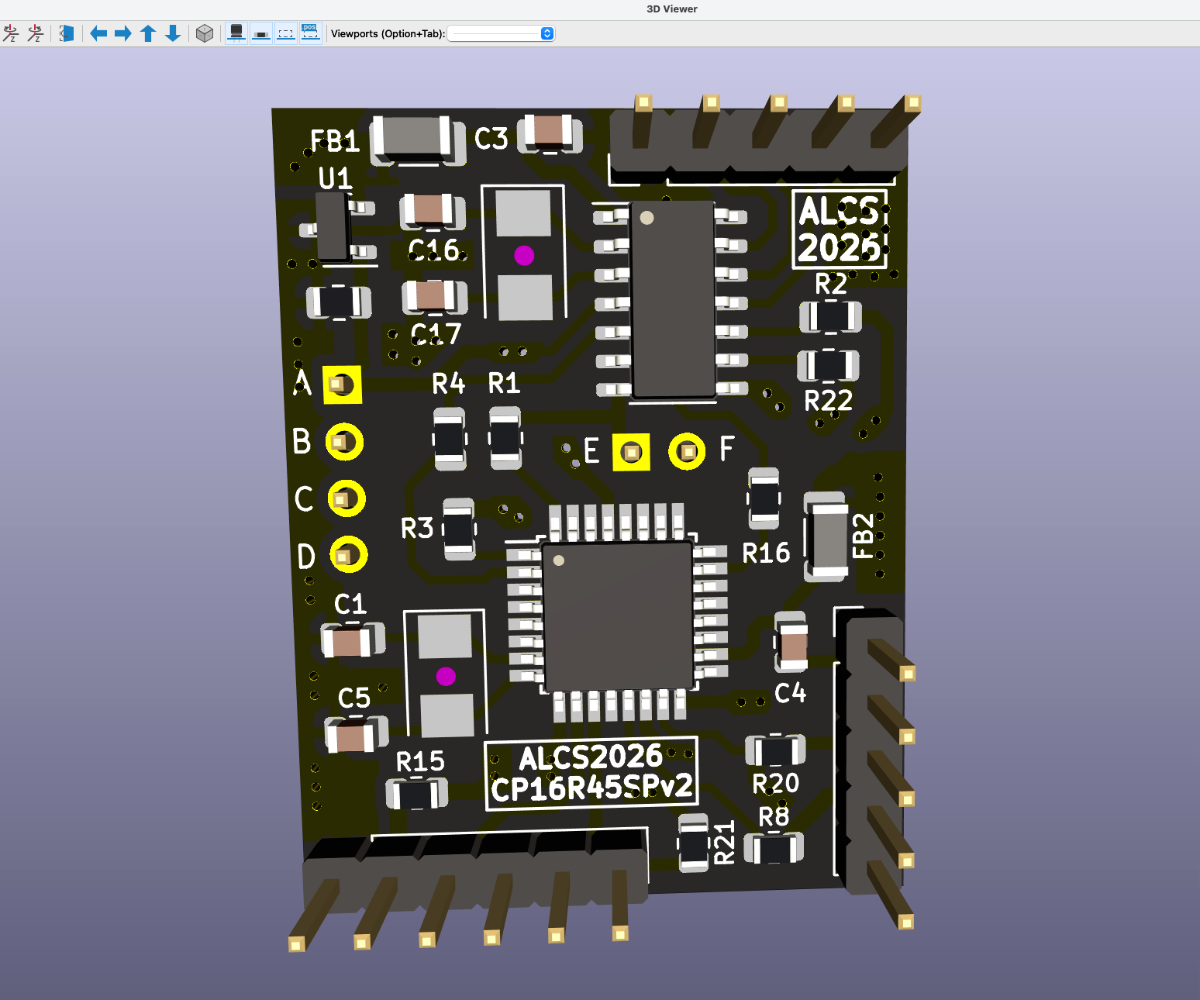

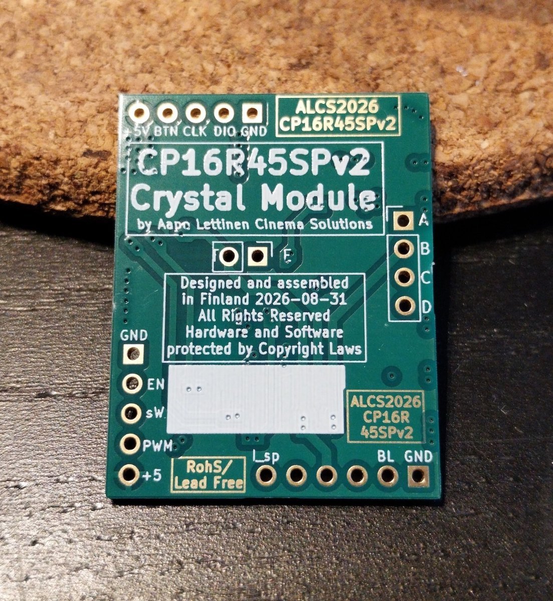

Premium Member Aapo Lettinen Posted September 4 Premium Member Posted September 4 this is how one designs easily user repairable devices. Difficult to solder black box stuff is in tiny modules and the whole rest of the main board is specifically designed to easily manually solder with tht components. And each connection designed to be easy solder with less than ideal soldering skills and poor quality tools. You don't want to start manually repairing any joints on that module even when it is relatively simple. Messing up 0603 sized tiny parts under conformal coating is not practical. And again black box stuff. The module is affordable enough that average cp16r hobby user could stock 5 or 10 of them if one wants. Just buy spares and stock them. Sell to others later for profit if you want. Designing the system like that to be repairable takes 7 or 8 x the time and is more expensive. The components are more expensive too. I can make the kits affordable because users assemble the main board and I only make the modules and software
Premium Member Aapo Lettinen Posted September 4 Premium Member Posted September 4 You can design a new black box module with same size and connections but different MCUs and software. That is one of the ideas of modules. You don't attach mcu directly to the huge mainboard. You are married to that MCU exact type and model and package then. With intermediate module you can redesign the whole module but keep the mainboard the same. These need to be pre planned and it is more expensive to design the device. But you need to plan for manual repairs if you want manual repairs
