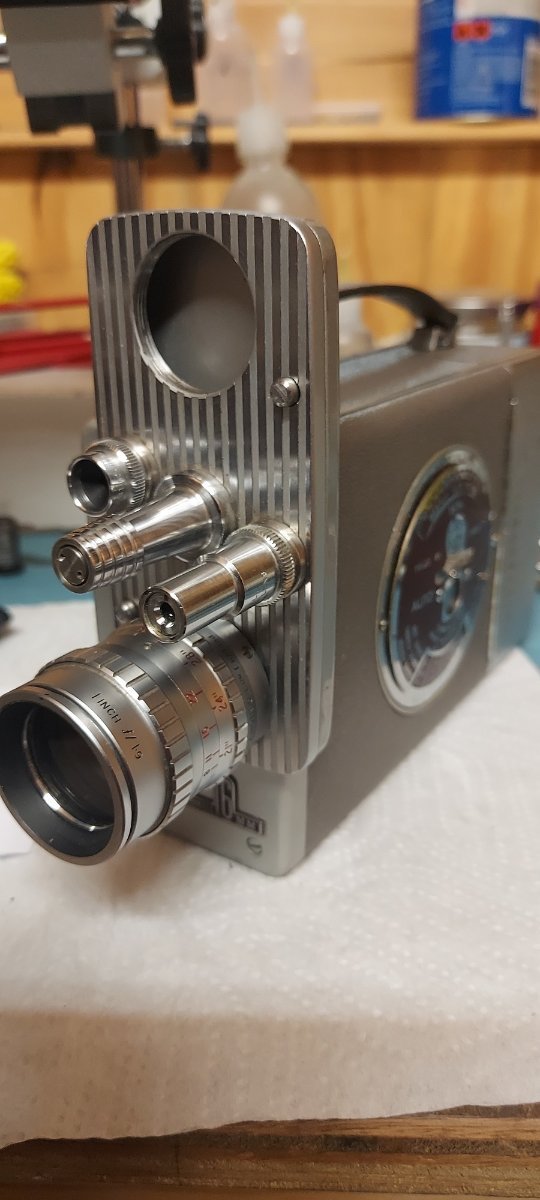

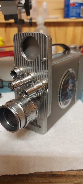

Kevin Cobley Posted September 8 Posted September 8 (edited) I have acquired (for near zero investment from a boot fair) a B+H 603T, which is a very pretty thing. It has a TTH Serital 1in F/1.9 lens in tip top condition and I have now fully stripped it down, cleaned and lubricated the mechanism and restored it to full function. It runs about 22-23seconds on a wind and the governor is now working properly and calibrated. In short it works OK and looks great. Now, I'm not a cinematographer (yet) and I started to look into if its possible to make a short film with the camera. I'm used to still photos in B+W from 35mm to LF and dev and scan myself with a hybrid workflow (on account of not having space for a LF darkroom 🙂 ). I started to look into how to load and shoot this camera and found fairly immediately that magazines are now completely dead technology, and even if I managed to re-load a cassette and shoot it that I might have trouble getting a lab to develop it. TLDR? I have two options: Climb the mountain to load shoot unload develop, splice and project double perf 16mm film magazines - having to do all of that myself Sell the Camera on and buy a Double 8mm rig to get me started (perhaps a C8 to get going), but probably still doing my own dev. It should be said that I'm crazy enough to prefer the full analogue route, as shooting a Canon 8mm and having the film lab deve'd and scanned is too close to using my phone and some post processing 🙂 Thanks for entertaining my folly , Kevin. Edited September 8 by Kevin Cobley

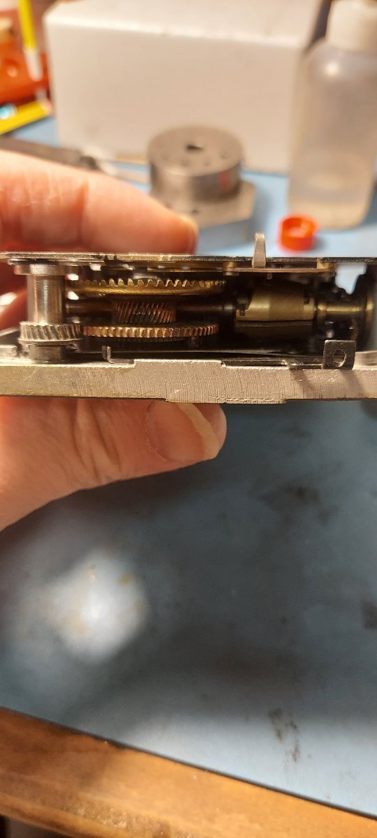

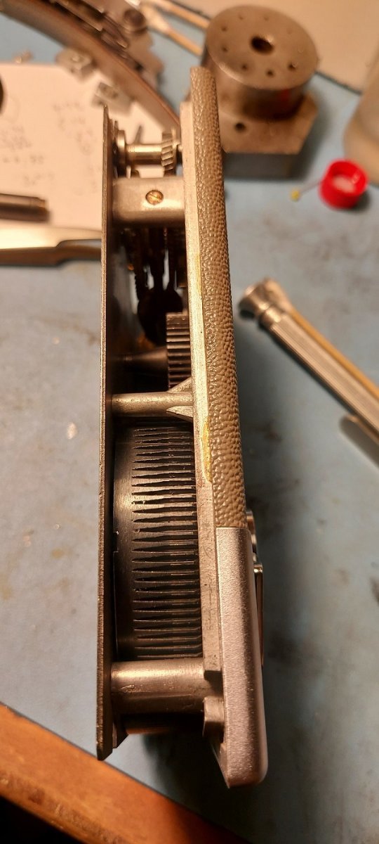

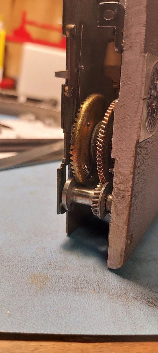

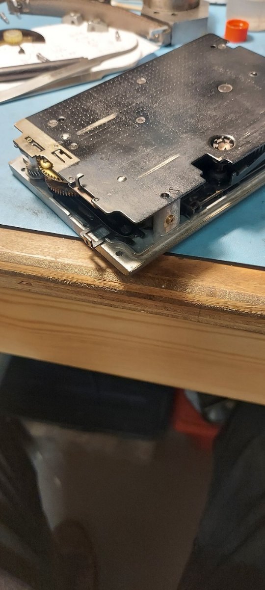

Kevin Cobley Posted September 8 Author Posted September 8 (edited) Attached some photos, and maybe some of you might be interested to see the guts. There's a fair bit of mis info out there about how these are arranged - the mainspring, for instance is not loose wound but is in a sturdy barrel making disassembly relatively safe if the spring tension is first relieved. To relieve the tension, after fully running the camera, once the turret assembly is removed, the gears of the transport can be hand run to let down the last of the spring tension I had to make a special spanner with a pair of pins to release the nut on the turret - it was very tight. Once that nut is off and the spring removed that is under it (dont let it join the swiss space race) then the turret face can be slid up to reveal the face plate. Four screws then remove the front face revealing the gears and the shutter disc. Once the face is removed, the wind crank can be removed with the big screw in its centre, and the four screws that hold the cover onto the main assembly. Once that is removed, the mechanism can be inspected. Undoing the flat internal plate with 5 or 6 screws releases most of the mechanism for disassembly. There is a spring that centres the run toggle - this fits to the end face - take note of how its mounted. Once the cover is removed, the governer can be removed next - undo the two lock screws in the main posts that secure the governor pivots - you may want to make mental note of their positions. One has an eccentric fitting that is for setting the depthing of the worm drive, the other calibrates the frame rate by setting how far the govener must move before reaching a friction plate which is what maintains the speed. Removing the long eccentirc tube with the camera set to 64fps just permites the removal of the govenor from the other end and then the main shutter gear is free to be moved. The govenor has some pivots that need cleaning and oiling so that the motiion is smooth, and some very light oil on the sliding cone. Also light watch oil for the pivot tubes. The gears havent been oiled themselves, and some light grease for the pivots of the main gear and the spring drum pivots. Lighter watch oil for the pivots of the gears that drive the shutter and the idler that also steps the single frame. The single frame works by using the metal slider as a fork escapement. The slider pushes up and releases the idler which then catches on the next fork of the slider, making exactly one turn less a bit, then the rest when the slider is returned to rest. This is a very simple and reliable system. The idler gear drives the scotch yoke that operates the sprocket advance slider with a pin in its top that must be made to engage the slider. This needs oilng with light watch oil but only a tiny amount. My camera was a bit gummed up and the govenor wasnt working right which meant slow faster speeds and wrongs speeds altogether. It also halted after about 15 seconds due to excessive drag. Now all speeds are correct and the mainspring runs for about 22-23 secs. The rate was calibrated by adjusting the govenor pivot before locking it down. The eccentic adjuster was set to give best running without slip or bind. Both are then locked down with grub screws on the main posts. Reassembly - there is a finger on the front plate the the shutter must be fed over before putting the front plate down, so setting the angle of the shutter is a bit tricky. The spring that pushes out the sprocket drive to the magazine is also tricky to get in place whilst the splined shaft is located and the head pushed under the locking lever and through the plate. Once re-assembled, I have an old kodachrome magazine, and it happily ran 10' without problems. Its a happy camera now, so as I said - time to work out if I can actually shoot some film with it or whther I'm going to end up with a heap of frustration. Edited September 8 by Kevin Cobley

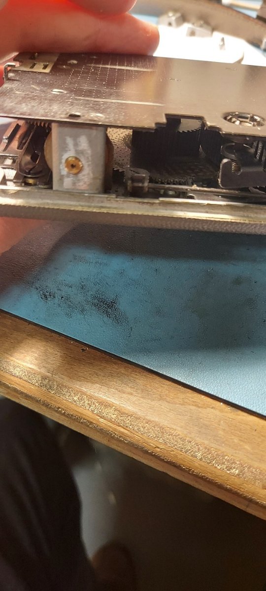

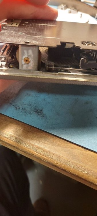

Kevin Cobley Posted September 8 Author Posted September 8 And further pictures: Â I forgot to mention the rather elegant felt and spring damper mechanism on the main shutter gear that handles the shock of being forced to stop so abruptly. There is a pawl not visible in the pictures which gets jammed into a ratchet tooth wheel on the back of the main shutter gear causing it to stop when the shutter button is returned. The wheel then gets a rather sharp jolt and the felt clutch takes the strain to prevent teeth parting company. Simple and effective, but take care not to leave the felt soaked with cleaner before testing.
Premium Member Simon Wyss Posted September 9 Premium Member Posted September 9 I should much appreciate that you in the future adapt the format of your photographs to the subjects, above all holding the device with the longer image side parallel to the longitudinal dimension. As a cinematographer you will only have the horizontally wider aspect for pictures and that preferably accomplished on a tripod. We like young people going after something, so be encouraged to do it all. As you’ve already learnt Bell & Howell products are well designed into every detail. The 603 is quite compact and thus always with you. Try some Ektachrome, focus diligently, rewards will come.

Kevin Cobley Posted September 9 Author Posted September 9 Thanks Simon, I agree the photos are not great. My apologies. Its one of the quirks of my phone that it autorotates. Very frustrating. I shot the photos to help me remember where everything goes. In future I should do a proper teardown and put together set for sharing. Well designed - very much so - ingenious, and all designed with a slide rule, no CAD, no rapid prototyping - just a mk 1 brain and a tobacco pipe and pen and paper. From my point of view this magazine camera poses some specific challenges: Double Perf - this limits film choices for me in the UK Lack of a lab processing option - at least I believe no UK lab will take a 50' roll or two 50' rolls spliced. Loading the magazine - I havent tried loading the mag, but its an extra hurdle, and a high probability of lost film - I can get mags for about £15-20 but I have no idea of how much wear they have. Thanks for the reassurance that this is not impossible, Brandon. I do have a mag which is part exposed Kodachrome which I view as a mechanical test roll. I may open that cartridge and see how it loads. A bit of me wonders what is shot on the exposed part 🙂 probably something really mundane. So I could try B+W dev to negative first. Which brings me to the developing. Assuming no lab will touch 50' of double perf, I'm left attempting to dev myself - that limits me to B+W, which is OK, and I'd probably opt for R100 reversal B+W which seems the only emulsion left in double perf. Then how to develop 50' of film? Lomo 50' tanks are crazy expensive now £250-350 on fleabay. An then there is the fun and games of trying to dry 50' of film at home. I'm out of my comfort zone and probably need advice ! Editing and projecting are then subsequent problems to solve later. Alternatively I can turn in the camera, maybe getting enough from selling it and its lens to pay for a double 8 camera like a Bolex or B+H Viceroy - still very analogue, what with loading and reversing the reels in a dark bag - it fits the game. Obviously quality will be a compromise, but I still get the fun of planning a silent movie with short shots and probably spend a lot less finding out if I enjoy it, but without the satisfaction of shooting the camera I got first. K.
