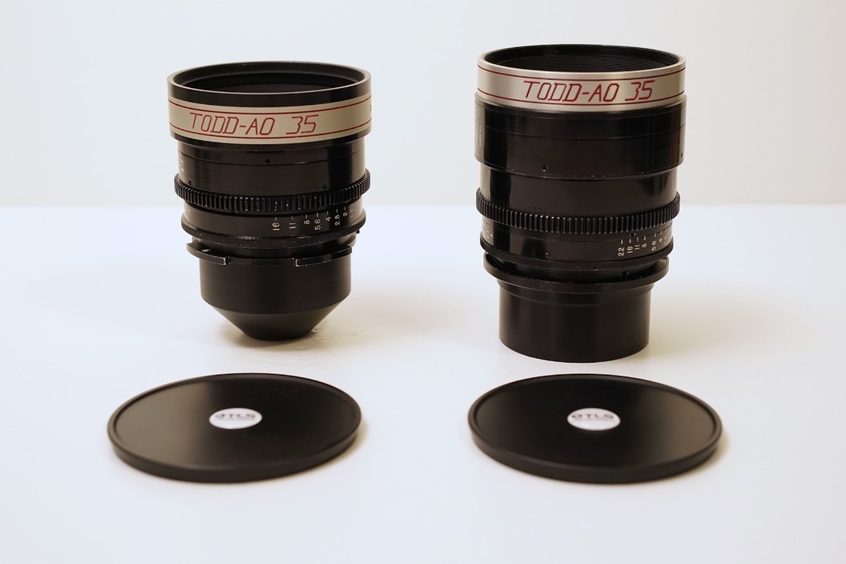

Steve Switaj Posted Thursday at 02:08 AM Posted Thursday at 02:08 AM Not lenses for the Fox Grandeur system, but here's a page on the ASC site about rehousing a set of vintage Todd-AO lenses from the second wave of 65mm in the 50's. https://theasc.com/asc-todd-ao-lenses/ I'm sure there are a million technical reasons I'm not privy to, but it seems unfortunate ZeroOptik could supply swappable mounts for PV, PL and LPL, but not for BNCR, which, as I recall, is kind of the default mount for a lot of the 65mm cameras of the 60's and 70's (except the Arri 765, I think that used it's own giant PL variant). I'm happy that someone can use these lenses again, but there's a certain sad irony if the rehoused glass that ushered in the early days of 65mm film... cant' actually fit on a 65mm film camera anymore.
Premium Member Daniel J. Fox Posted Friday at 06:38 PM Premium Member Posted Friday at 06:38 PM On 10/1/2026 at 3:08 AM, Steve Switaj said: Not lenses for the Fox Grandeur system, but here's a page on the ASC site about rehousing a set of vintage Todd-AO lenses from the second wave of 65mm in the 50's. https://theasc.com/asc-todd-ao-lenses/ I'm sure there are a million technical reasons I'm not privy to, but it seems unfortunate ZeroOptik could supply swappable mounts for PV, PL and LPL, but not for BNCR, which, as I recall, is kind of the default mount for a lot of the 65mm cameras of the 60's and 70's (except the Arri 765, I think that used it's own giant PL variant). I'm happy that someone can use these lenses again, but there's a certain sad irony if the rehoused glass that ushered in the early days of 65mm film... cant' actually fit on a 65mm film camera anymore. Rather than use BNCR, I believe the Todd-AO 65mm lenses had their own custom lens mount that required the lenses to be physically bolted onto the cameras... this is certainly the case for the lenses that the ASC had rehoused. That said, if anyone wants Todd-AO 65mm lenses on BNCR, I have a pair for sale.
