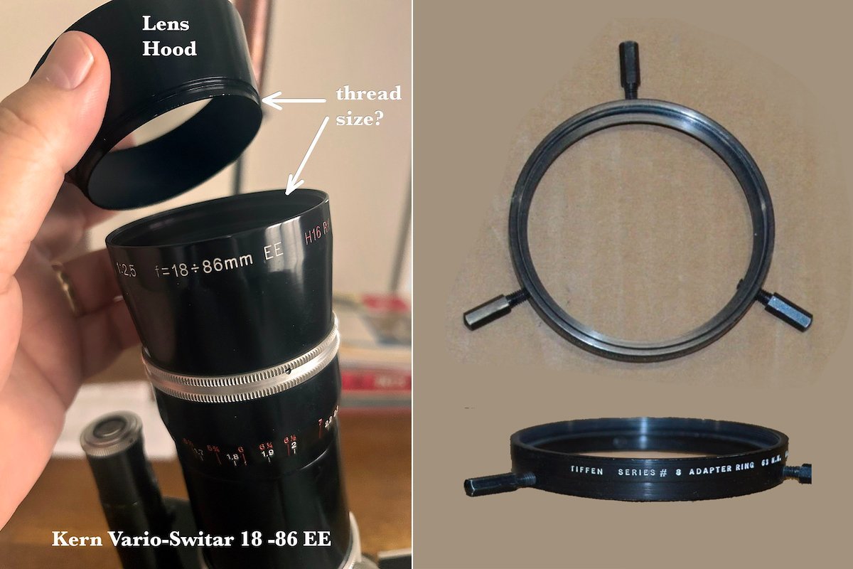

David T. Nethery Posted July 24 Posted July 24 I realize this is an old post I'm bumping up , but because we're dealing with old cameras and lenses here, any of this information is already frozen in time and when it is shared it is "new" and relevant info for anyone trying to get good use out of these fine old Bolex cameras. Does the type of clamp-on Tiffen filter adapter mentioned above look like the one shown below (which says for Series VIII , not for Series IX , but I’m thinking this might be a good match for the Kern Vario-Switar 18-86 EE because it does specify that it takes SeriesVIII filters) . If this ring is clamped on to the front of the Vario-Switar 18-86 EE , I should be able to use more than one Series VIII size filters and then the lens hood screws into the adapter ring to hold them in place or are there actually screw-in (threaded) Series VIII size filters that screw in to this adapter ring? Also, has anyone ever found the exact thread pitch size for the lens hood that screws on to the Vario-Switar 18-86 EE ? Or is it simply not a standard thread , but specific to this lens only ? I can't find anything about it in any of the Paillard Bolex literature. Only a brief mention that the Vario-Switar 18-86 EE takes Series VIII size filters that are intended to be held in place (only one at a time) by the Lens Hood. The Paillard Bolex literature has no mention of using screw on threaded Series VIII filters (if there are such things?) or adapter rings to hold more than one Series VIII filter at a time.

David T. Nethery Posted July 26 Posted July 26 (edited) On 7/24/2026 at 3:26 PM, Simon Wyss said: ISO-Feingewinde II (DIN 13-3) M 66 × 0,5 Thank you for that information, Simon. So it seems Paillard Kern chose to use a non-standard diameter and thread pitch on the Vario-Switar 18-86 EE lens. As far as I can tell, there are no screw-in filters that fit the M66 × 0,5 configuration of the lens (only the drop-in Series VIII filters held in place by the lens hood ... but in that case you are limited to single filter). Despairing of finding any filters or adapter rings that are M66 × 0,5 pitch, I did find this company, SK Grimes, who will custom machine a slip-on filter adapter ring that slips around the outside barrel of the lens. https://skgrimes.com/slip-on-filter-adapter/ Edited July 26 by David T. Nethery
