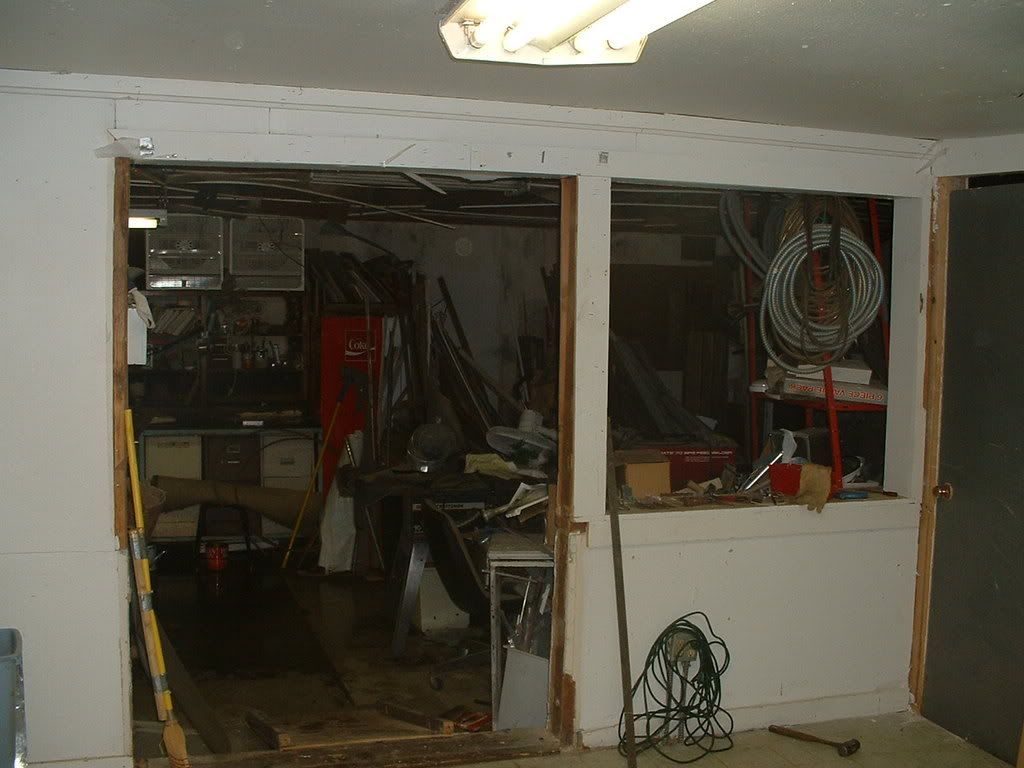

Premium Member Charles MacDonald Posted January 20, 2007 Premium Member Share Posted January 20, 2007 The only point of direct access to the exterior of the building from the lab is the small rear window where the window A/C unit will be installed. This widow will be removed and the space completely framed in and sealed except for the A/C inlet it's self which will be double filtered. The exaust fan will not have the CFMs that the A/C has especially on "High" , so although the exaust fan (which will also be filtered and sit directly over the processor) will be drawing air out of the room, it will be replaced with an abundence of fresh cleaned air from the A/C, maintaining, I believe, a positive air pressure in the lab's interior with all doors closed. I remember Window A/C units. I think that you will find that most of them will draw air from the room, and run it though a rudimentry filter, then through some cooling coils, which will also remove some water, then BACK into the room. At the same time you draw OUTSIDE Air in the sides of the outside part of the unit where it is heated up some more from the heating coils and sent on its way out the grill at the back. The water that condenses on the cooling coils has a little chanel to run out and drip on your garden. There is a bit of Uncooled unfiltered outside air that comes in if the selector is set on "ventalate". Open the cover on the unit and marvel at how little conection their is between the front and the back. Quote Link to comment Share on other sites More sharing options...
James Steven Beverly Posted January 20, 2007 Author Share Posted January 20, 2007 (edited) I remember Window A/C units. I think that you will find that most of them will draw air from the room, and run it though a rudimentry filter, then through some cooling coils, which will also remove some water, then BACK into the room. At the same time you draw OUTSIDE Air in the sides of the outside part of the unit where it is heated up some more from the heating coils and sent on its way out the grill at the back. The water that condenses on the cooling coils has a little chanel to run out and drip on your garden. There is a bit of Uncooled unfiltered outside air that comes in if the selector is set on "ventalate". Open the cover on the unit and marvel at how little conection their is between the front and the back. You maybe right. I may have to go with an evaporitive cooler, but that brings a set of other problems with it. I have 2 refer andd 1 evap window units. I'll have to figure something out. I am determined to find a way to keep positive air pressure in the lab. In the mean time on to my report: Sell the house, cash in the bonds and throw one last fling because WE GOT SNOW!!! 2 snows in one season in El Paso, the Apacalyse is apon us. WELLL, to be fair the "snow storm" was a light dusting of snow this morning which lasted about 20 minutes then turned into a long day of drizzeling rain that lasted into the night, is still going on and LOOKS like it will be continuing for the next 3 or 4 DAYS!!! NOT a thunderstorm, mind you, just a light continuous drizzel that seemed to seep into every tiny inperfection there was on our terrible roof. I spent most of the day trying to get 30 odd or so containers of all descriptions under the torrid of leaks that plagued the studio. Rain like this is worse than a down pour because if there are ANY leaks at all, they will be dripping. I did what I could and contained the major leaks but the floors of the lower section of the studio were our sound stages are were soaked. Sence this WAS a pitched battle , I didn't get much work done on the lab per se', but I did SOME work done. I finished rounding up all the hardware we needed and installed most of it. I also solved a problem that's been frustraiting me. One of the openings needed a 34in door which I don't have and because I didn't want to buy anything I didn't have to, I was trying to figure out what I was going to do. I wanted to keep the doorway useable and not frame it in but the only way to do that was to cut down a 36in interior door which I do have but which would have been a pain to do. I kept thinking I needed to keep the doorways wide, then today I thought "Why? We HAVE a 5ft wide doorway as the main entrance" Sometimes I feel I'm too stupid to live. I guess you just get set on doing something one way and don't consider alternitives. I found the widest door I have left which was 30in and set it into the portal, added 2 2x4s and whatdaknow, it works! I'll frame it in tomorrow. I installed the hardware on most of the doors and now all that's left is to hang them and seal them up. I'll also make a decision on the larger window tomorrow and work on that. Once that's done, I install the cooling and ventalation systems and the lab is sealed, I'll move the equipment in there and bomb the joint for mold which ALSO horrendous because the the continuing leaks. I've been working in there with the doors wide open to let in fresh air and making sure I have a mask on at all times but I can't work in there with actors until the mold is irraticated. Fortunately me next door neighbor at the studio is in the buseness of water damage restoration and has ALL the chemicals needed to take care of this problem. He owes me one because I let him store his vans on part of our back lot so He said he'd even do it for free. Once the roofers finish the roof, I'll have him bomb the place and that SHOULD take care of the problem. I had hoped to have better news to share but that will have to wait until tomorow...or next WEEK if the damn rain doesn't quit. Regardless, more tomorrow. B) Edited January 20, 2007 by James Steven Beverly Quote Link to comment Share on other sites More sharing options...
Matthew Buick Posted January 20, 2007 Share Posted January 20, 2007 I do not see any likely possibility where you could destroy 100,000 feet of film, unless you happen to be working with a film processor which runs 100k at a time :D Oh ho ho...that Borowski...had me so worried...I'LL FU**ING MURDER HIM!!!! :angry: :angry: :angry: :angry: :angry: Quote Link to comment Share on other sites More sharing options...
James Steven Beverly Posted January 21, 2007 Author Share Posted January 21, 2007 (edited) I had pics but can seem to get them to attach. This is ALSO frustrating. Edited January 21, 2007 by James Steven Beverly Quote Link to comment Share on other sites More sharing options...
James Steven Beverly Posted January 23, 2007 Author Share Posted January 23, 2007 (edited) And now for the news, It was reported today that I finished installing the last of the doors. This report is highly dubiuos however and should be taken with a grain of salt. Dispite this I DID actually, FINALLY finish installing the damn doors today and find is hard to believe myself! I actually believe I should get an honorary Oscar for best achievement in door hanging to complete a movie or at the very least a round of applause. I wll start weather stripping and sealing them tomorrow. This has been a lot of work but it is starting to pay off. I am positive I can achieve a nearly air tight, fully controllled enviroment in the lab. I was suppose to have some help with this but, hey I guess you get what you pay for. :rolleyes: That's OK. It's getting done and that's the important part although it really is a bitch to hang a series of doors by ones self, particularly when one is dressed in a bulky mechanic's snow suit so that one could leave the main building doors open to allow the rain slicked floors of one's studio to dry out without having one's willie freeze off. So as a result, while trying to prop one particularly heavy door designed not for the interior use I was putting it too but apparently made for the front entrance to a nuclear weapons facility and built to withstand a cannon assault from the Hun with my foot while holding a drill in one hand and a hammer in the other, I started using curse words I had forgotten I knew. It didn't help that everything I was using was old and used. One of the doors was warped which I'd never seen before and made for an interesting doorframe. I got it to seal though. I still have to deal with the large window opening, eather try to save it with some types of doors that would allow it to open or lose it by completely framimg it in which would be simplier, although I've never been known for doing anything simply. I've got some of the guys coming over Friday to help out but the majority of the work, at least on the lab may be done by then. I still have to rest the electrical for the 220 and install all the fans, A/C, heating and air filtration units but everything in it's time. I want to get done though so I can start shooting some second unit stuff for Blood Moon Rising to test the machines and learn to use them. It should be interesting. I did have a couple of questions for Dominic, David or anyone else out there that might know the answers to: 1) Does humidity affect processing and if so how and what can be done to stablize this factor? 2) Aside from mataining exact bath temps, consistant chemical mixing, mantaining a dustfree environment, proper schdualed mantaince and cleaning of equipment and proper storage of chemicals, waht other factors can help to keep a consistant look this the processing results? 3) Asisde from Dominic's book, Film Technology in Post Production (Which is the next book I get) what other good materials are ther out there on Motion Picture processing, are there and videos anyone is aware of? Thanks-The Captain B) Next report tomorrow! Edited January 23, 2007 by James Steven Beverly Quote Link to comment Share on other sites More sharing options...

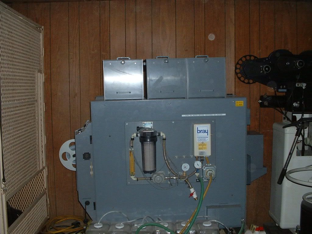

Richard Tuohy Posted January 26, 2007 Share Posted January 26, 2007 Your third best friend will be a dust free drybox and there are allot of tricks to this a set of large surgical grade hepa filters and a enclosed film takeup wiith a set of large PTR's will give you film which does not necessarily need to be post cleaned. We do recover enough silver every month to pay for our silver collectors and more! -Rob- Robert, can you tell me more about your third best friend? Is the 'drybox' a room or a cupboard/compartment or the last stage in the processing machine? Would be very useful to know a bit more about what you advise here. Cheers, Richard Quote Link to comment Share on other sites More sharing options...
James Steven Beverly Posted January 27, 2007 Author Share Posted January 27, 2007 Well for mine, Richard, it's the last stage in the processing machine. I'll look at it in more detail when I get it into the labroom. I want to post photos but there doesn't seem to be enough room in my account here to do that. This is SOOO frustraiting. I want to share my pics with you guys but I can get the photos to attach and when I do, they're so small you need a microscope to see them. CAN ANYONE HELP ME WITH THIS PROBLEM????!!!! ADMINISTATION... Someone? I've seen pics posted that were normal web sized pics. WHAT am I doing wrong or do I have to be allowed more space to post pics. Please let me know. Now on to my report: Today wasn't a lab building day per se'. I had some help from one of my guys for a change so I decided we tackled a job thast need to be done but which I dreaded attempting alone. clearing, cleaning and re-organizing the scene shop which was in a dismall disarray. It has been something I have been wanting to do for a long, LONG time. The mess had grown like the Blob in a movie theater full of horny teenagers and had started to invade the adjacent sound stage and was becoming a problem that threatened to over whelm that area as well and it was time to call in the CO2 fire extiguishers. I needed to clear a pathe trough the drbris in order to the processing and step printer machines through the scene shop and up into the lab. So becuase this was a task I didn't want toi face alone unless I had to, we took a break from working on the lab and dealt with the mess instead. My friend Mike and I moved 2 pick up loads of stuff out of the scene-shop and into a couple of cargo van bodies I bought a while back to use as storage sheds. They worked out great although I should put some sheet metal in the front window opening so I could untilize the entire length of the van bodies, but all in all they keep thing quite dry and safe. I will eather finish off the cleaning tomorrow or get back on the lab. The next step there will be to intall the A/C, weather stripping and dustproof thresholds.The we'll tackle the positive pressure and ventallation problems after that. I did find out today that the electronic particle filters I was planning to use put out an inordinate amount of Ozone, which in a sealed room could be problematic to say the least. It takes a least a couple of months to train lab people so if any of them should accidentally die from ozone poisoning, it might but us behind schedual. This makes the need for proper ventallation even more critical, so I'll definately have to come up with solutuions to these and other problems. Not to worry, I WILL make this work. More tomorrow. B) Quote Link to comment Share on other sites More sharing options...

Premium Member Jason Debus Posted January 28, 2007 Premium Member Share Posted January 28, 2007 I did put them on photobucket www.s163.photobucket.com/albums/t296/CaptVideo1/ for anyone who cares to take a look. These images are from about a week ago. all the openings now have doors installed and the large window opening is framed in and in the process of being sheet-rocked as is the area where the pipes show. Let me know what you think. You can also link offsite to photobucket (and other pic sites) which is actually what I like to do to save Tim bandwidth. I guess since you put the link you wouldn't mind if I thumbnailed them: Quote Link to comment Share on other sites More sharing options...
