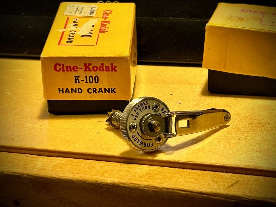

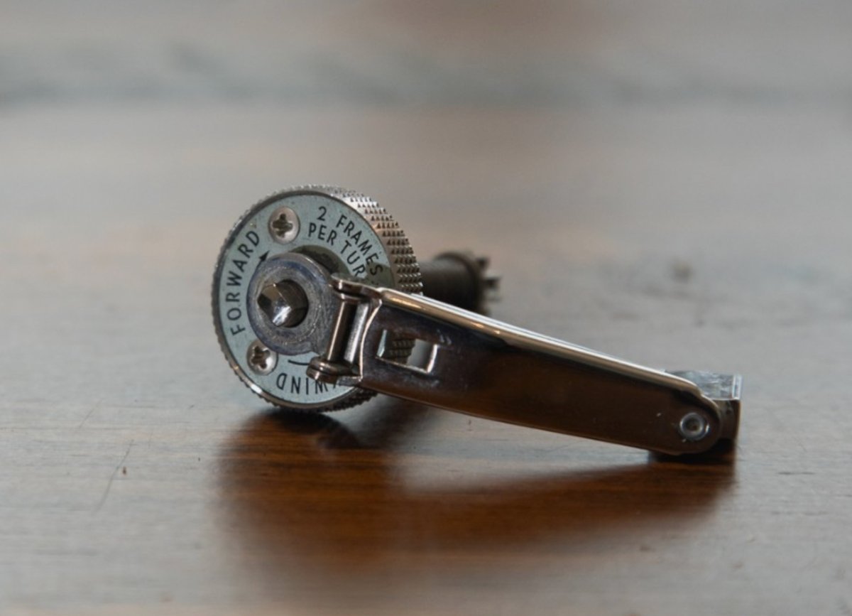

David T. Nethery Posted August 7 Posted August 7 (edited) On 5/17/2007 at 5:07 PM, Herb Montes said: That handcrank is very rare. I've been wanting to find one or at least make one for my cameras. You wouldn't mind taking pictures of it to show us how it looked. I can probably figure out how to machine my own. Hi, Herb, Old topic, but I wonder if you ever found a K100 hand crank or machined your own ? ( now with the advent of 3D printing small accessories I wonder if someone could figure out how to 3D print one ? Probably not as it has to be really strong , made from metal ...) For anyone interested in the K100 hand crank, I put up an album of photos showing it from all angles.(from photos I've collected over the years). There were recently TWO of these hand cranks that sold on eBay in June 2026 and I totally missed them! (one was for only $12.00 !) Cine Kodak K-100 Hand Crank Album https://photos.app.goo.gl/Mr7syhFYVcMhQgrE9 Edited August 7 by David T. Nethery
David T. Nethery Posted August 18 Posted August 18 (edited) Well, thanks to a member of another forum where I posted about wanting to get a K100 hand crank I now own one! Looking forward to trying it out. It just goes to show that these rare items are out there, but you just have to be patient and keep looking. Edited August 18 by David T. Nethery
