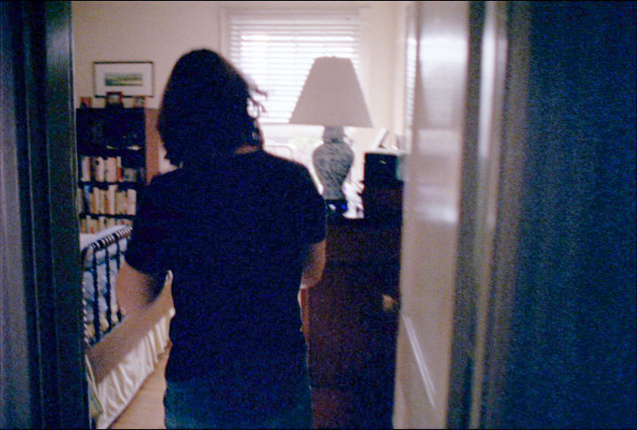

Premium Member Adam Thompson Posted September 14, 2007 Author Premium Member Posted September 14, 2007 Ok I got a .jpg showing the extreme of the example. The back of the girl and the dark part of the bookcase on the left is where it really shows. Though on my laptop right now I can't really see it. CRT it's very clear. Also on this PC it looks a little underexposed further into the room but on the Mac it looks a stop or two brighter. ? He said there was only the sunlight coming into the room through the window you see, no other lights. There is a little motion blur as the camera was moving right behind her, both going toward the light.

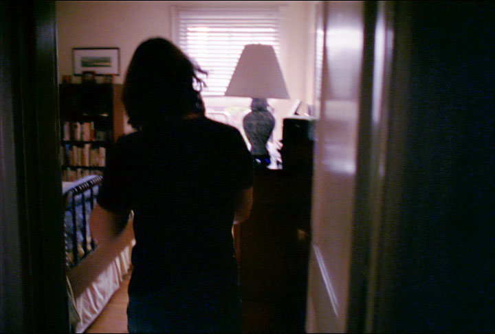

Thomas Worth Posted September 14, 2007 Posted September 14, 2007 I doesn't look that bad to me. However, if you pump up the dark areas, you can see some big blue grains. Is this tungsten balanced stock? Your blue channel is the grainiest: If you've got the footage as 10 bit uncompressed data, you should be able to remove the excess blue easily:
Site Sponsor Robert Houllahan Posted September 14, 2007 Site Sponsor Posted September 14, 2007 I doesn't look that bad to me. However, if you pump up the dark areas, you can see some big blue grains. Is this tungsten balanced stock? Your blue channel is the grainiest: If you've got the footage as 10 bit uncompressed data, you should be able to remove the excess blue easily: I remember transfering this the other day, it's tungsten stock under mixed lighting and some of it is underexposed. The girl moves from fluro to tungsten to daylight rapidly. I assumed that because it's a test you would want to see the effects of the changing lighting and I found a setting that seemed to balance all the different lighting settings relatively well. If you go from tungsten light to daylight without a 85 the blues are going to get a bit funky and add a bit of under exposure to that and you will get some noise. As someone else said with a 10bit disk recording you can easily work in fcp to do additional color correction, also considering our ridiculously low minimum (I think the xfer cost you 82.50 with the disk recording) I don't think you could get as good a transfer that you could manipulate anyplace else for that. -Rob-

Premium Member John Brawley Posted September 15, 2007 Premium Member Posted September 15, 2007 Ok I got a .jpg showing the extreme of the example. The back of the girl and the dark part of the bookcase on the left is where it really shows. Though on my laptop right now I can't really see it. CRT it's very clear. Also on this PC it looks a little underexposed further into the room but on the Mac it looks a stop or two brighter. ? He said there was only the sunlight coming into the room through the window you see, no other lights. There is a little motion blur as the camera was moving right behind her, both going toward the light. Hi Adam. I have to say, for an unsupervised transfer in what looks to be mixed lighting, it seems to be OK. In the image you present I can BARELY make out a bias in the blacks. It's only when you lift it as demonstrated you can start to see it. But are you planning to grade it that way ? I actually think it looks pretty good given the conditions you describe... jb
Premium Member Adam Thompson Posted September 15, 2007 Author Premium Member Posted September 15, 2007 Hey guys. Just relayed the comments via phone (he's shooting a short for someone that may end up at Cinelab again). Said this particular shot had only the sun coming in that window, no mixed or other lights, though there were mixed lights in other shots of this test. Also it was perfectly exposed as the progress of this shot shows though this still may not illustrate that well, but what would any of that have to do with the blue anyway? Some other shots in the test were purposely underexposed and some purposely had flares, etc.. Rob, were you reffering to these others shots when you said "....it's tungsten stock under mixed lighting and some of it is underexposed."? Just wanted to clear that up. The stock was 200T Kodak (7217) and this particular shot had an 85 on it, the one or two before it did not. He waited till about 6pm to do this shot as the sun starts coming into the apartment through some buildings and a tree or two outside. It fills the room to about a 2.8 via bounce from the bright walls. This was a best light transfer. If it would have been scene to scene corrected, would this issue still come up do you think? Cinelab did a transfer for me on a short a couple years ago and it was fine so I'm not trying to make anyone look bad, we just want to clear up how to avoid this issue in the future. And correcting it for the blue at this point would also change the color of the girl's denem skirt, and other things, wouldn't it? I'm not into CC work that much but was wondering how, in FCP, would be the best way to do it. The G5 has Final Cut Studio and Magic Bullet on it, if that helps. I'll try to get a well exposed still from another shot in the same room if you guys want. It's cool that a frame can be posted here and the guy that did the transfer would end up responding to it! Thanks Rob.

Site Sponsor Robert Houllahan Posted September 17, 2007 Site Sponsor Posted September 17, 2007 This was a best light transfer. If it would have been scene to scene corrected, would this issue still come up do you think? I'll try to get a well exposed still from another shot in the same room if you guys want. It's cool that a frame can be posted here and the guy that did the transfer would end up responding to it! Thanks Rob. I usually run tests like this with minimal changes, I think there were 3 notches on the CC for this, as I would think that seeing an overall look with minimal correction will give you a better idea of the performance of the stock under the lighting conditions you are working under. Any time you are working with a colorist a discussion about the look you are going for is a must, I could have timed the blue out as was done with the stills in photoshop or made keyframed changes as she moves from the dark into the brightly lit room. There is so much room to work the picture in color correction that a understanding of the artistic intent really should be conveyed to the colorist as anybody doing this work will want to get you what you intend and more. -Rob-
Premium Member Phil Rhodes Posted September 17, 2007 Premium Member Posted September 17, 2007 I don't see that it's horribly, horribly wrong. Maybe a bit pink in the highlights, maybe a bit blue in the shadows, but not smack-in-the-face incorrect, certainly. A Rank 3 with every upgrade in the book and properly aligned (which Mr. Houllahan's comments indicate this one is) should be able to produce at least fairly reasonable results. Phil
