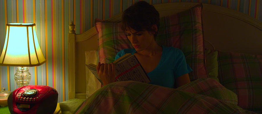

Premium Member David Mullen ASC Posted December 16, 2010 Premium Member Posted December 16, 2010 Here's an example of what I'm talking about: I shot this on the old Red One sensor, basically put a bright bulb in the shade (probably a 100w), set the iris to the point where I liked how hot the shade looked, and her face was more or less lit by the lampshade, I just augmented it with a small amount of soft lighting from the same direction as the lamp, but most of the light her face is from the lamp, so it feels pretty natural. Yes, her face is a bit underexposed and in post, I could have brought her side of the frame up and the lampshade down. Here's my poor Photoshop attempt at bringing up her face a bit:
Robin R Probyn Posted December 16, 2010 Posted December 16, 2010 Here's an example of what I'm talking about: I shot this on the old Red One sensor, basically put a bright bulb in the shade (probably a 100w), set the iris to the point where I liked how hot the shade looked, and her face was more or less lit by the lampshade, I just augmented it with a small amount of soft lighting from the same direction as the lamp, but most of the light her face is from the lamp, so it feels pretty natural. Yes, her face is a bit underexposed and in post, I could have brought her side of the frame up and the lampshade down. Here's my poor Photoshop attempt at bringing up her face a bit: Hi Dave Really nice how you share your knowledge .. alot of DP,s would keep their tricks to themselves.. I guess you have the confidence to share them.. thanks..
Ari Schaeffer Posted December 16, 2010 Posted December 16, 2010 (edited) Just curious, is the soft key gag in your example a booklight? Or just single diff (bounce with no diff, or just unit punched through diff)? I usually tend to go with china balls as my gag source for in play practicals like that, since I always found that it seemed to match the quality of light that a lampshade gives you. Wondering if the booklight may be the nicer choice.... My guess, based on the falloff on her face, is that it wasn't super diffused, but I'm dying to know :P Edited December 16, 2010 by Ari Schaeffer

Premium Member David Mullen ASC Posted December 18, 2010 Premium Member Posted December 18, 2010 Just curious, is the soft key gag in your example a booklight? Or just single diff (bounce with no diff, or just unit punched through diff)? I usually tend to go with china balls as my gag source for in play practicals like that, since I always found that it seemed to match the quality of light that a lampshade gives you. Wondering if the booklight may be the nicer choice.... My guess, based on the falloff on her face, is that it wasn't super diffused, but I'm dying to know :P No I don't think so -- it may have been a Chimera on a unit put through an additional frame of diffusion -- I often put a Woodylight or BargerBaglite through a 4'x4' frame of 129, which is a heavy white frost.

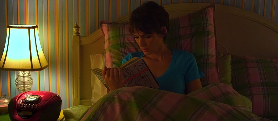

Andrew Wilding Posted December 18, 2010 Posted December 18, 2010 No I don't think so -- it may have been a Chimera on a unit put through an additional frame of diffusion -- I often put a Woodylight or BargerBaglite through a 4'x4' frame of 129, which is a heavy white frost. I use the same approach, but often find that the result is too flashy or lit looking. Example I think it might be an issue of demanding a full exposure on the face - perhaps keeping the face a stop under or so will let the practical do a little more of the lifting and call less attention to the additional lighting.

Steve London Posted December 20, 2010 Posted December 20, 2010 I use the same approach, but often find that the result is too flashy or lit looking. Example I think it might be an issue of demanding a full exposure on the face - perhaps keeping the face a stop under or so will let the practical do a little more of the lifting and call less attention to the additional lighting. Hi Andrew, I think your frame is nice-looking and don't think most people would stop and stare so long that they got out of the illusion by studying the shadows. That said, the actor and left side of the frame look right, but the right-hand side is obviously lit because the lamp could not have illuminated the sheet from the right side and so far toward the bottom right. If you'd flagged your movie light off that side it all would have worked nicely. Still, a good-looking frame.

Premium Member David Mullen ASC Posted December 20, 2010 Premium Member Posted December 20, 2010 I use the same approach, but often find that the result is too flashy or lit looking. Example I think it might be an issue of demanding a full exposure on the face - perhaps keeping the face a stop under or so will let the practical do a little more of the lifting and call less attention to the additional lighting. I like the shot, it's just that it is a bit more dramatic and stylized, and there's nothing wrong with that. That light on her face could be justified (if necessary) as coming from some other source off-camera, not necessarily the lamp right next to her, it could be light spilling from another room, or through a window, or a larger lamp in the room, etc. There are lots of reasons to have the key at full exposure rather than underexposed, for example, maybe there is a camera move that goes into a close-up and once the face is filling the frame and the hot practical is off-camera, you'd rather have a full exposure on the face so that the overall image is not underexposed-looking but has good highlights.
