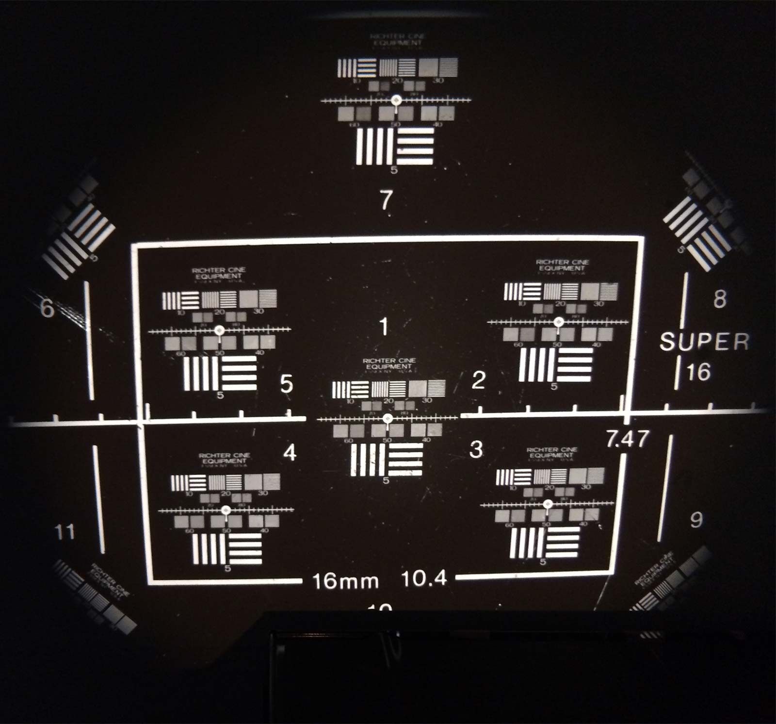

Premium Member Will Montgomery Posted January 21, 2014 Premium Member Share Posted January 21, 2014 I put my 10-100 converted to 12-120 (By Charles at Serious Gear) on a projector last week and it looks like from about 24+ it would cover the Black Magic 2.5k sensor. This is at about 24mm on the zoom. Quote Link to comment Share on other sites More sharing options...
