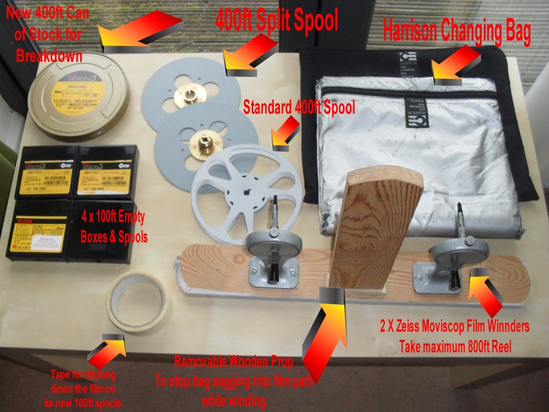

Gareth North Posted May 1, 2014 Posted May 1, 2014 Hi Matthew,The subject line of your forum posting is something that i needed to figure out for the 1st time some years ago myself having purchased some film at a good price that was sold in 400ft cans. Although I had a 400ft mag for my camera I didn’t want to lug the extra weight of a Mag, external motor and take up motor to shoot (I use a Bolex) so 400ft Breakdown to 4 x 100ft spools was the answer! But how to go about it???So we're in the taking pictures game so here's a picture of all the parts i need to use to do a 400ft 16mm breakdown:- The way I do it I think is the most practical and inexpensive way which uses film items that you can use outside of just breaking down a film.I already owned a changing bag which is always a practical item to own anyway which will be in most shooters kit bag. If you haven't got one to load a camera or mag in total darkness I'd recommend it. Next item on the list is a standard 400ft reel which you should be able to pick up for next to nothing. A 400ft split spool might be a bit more expensive but i find it also use full getting prints onto projection reels from cores and managing the moving of shot film in and out of cans / projection reels. To move that film on those reels you'll need some small film winders that handle a reel no bigger than 800ft, my Zeiss ones are perfect any bigger and they won't fit in the changing bag. For nothing at all you can make the wooden base you see in picture to hold the winders and a bit of wood that sticks up to hold the bag up when winding. Next grab some spare 100ft boxes from a lab that’s quiet happy for you to have them for nothing and make sure you ask for em back every time you send them to them with film in for processing.Procedure1) Put everything into the bag, zip up, put your arms into the bag and untape the 400ft can and stick its tape along the sides of the wood stand.2) Take film out the can and its plastic bag and put on the split spool and connect together both sides of the split spool and put the split spool on the left winder and put the empty standard 400ft reel on the right winder.3) Unpick the tape holding the film, reposition upside down if film not coming off top right of the split spool and move film across to top right of empty standard reel and start winding clockwise all 400ft from split spool onto standard reel.BY DOING THIS THE B WINDING ORITENTATED FILM IS TURNED INTO A WINDING FILM WHEN ON THE STANDARD REEL4) Remove split spool from left winder and put somewhere safe in bag its task done and move standard reel with all film on it now from right to left winder put 100ft empty spool on right winder make sure again film comes off top right from standard reel and goes to top right of 100ft spool and wind 100ft or more as desired onto 100ft spool. Once you have the 100ft reel full you can usually break all non estar base film by just folding and pulling it apart No knife or cutter required.THAT 100FT SPOOL WILL HAVE THE FILM BACK IN B WINDING ORIENTATION READY TO SHOOT5) Stick tape on film on 100ft spool put in plastic tray in box and tape 100ft box up. Repeat for next 3 100ft spools.I have used this setup around 15+ times now! When I first used it I thought it might introduce dust and dirt onto the film but comparing Kodak 100ft loads with my own creations after processing and Scanning no discernable difference was seen so I’ve kept doing it! Make sure bag and everything you put in it is spotless and you'll be fine.I was interested to read everyone else's take on how to accomplish the same thing. Obviously if you have a complete dark room in your house you can use that but who does have access to one of those? Or want to convert a room to be like that. Its soo much effort and you can't take the room with you to a location. So just get a bag simpler!You also don't need night vision goggles. I suppose if you’re a lab dealing with film in your own darkroom everyday it makes sense but not really though for us! Plus what do you do with the night vision goggles when you’re not breaking down film. Umm No answer :)It will take hardly any time to get into the swing of doing it this way. Interesting comment from an earlier poster about winding slowly in order to avoid static light fogging film. I always forget about this anomaly and have to admit I usually want this procedure done quick (about 30mins per breakdown) anything longer and the bag takes on a humid ecosystem of its own and it becomes a bit muggy in there. So I usually wind like a man possessed the film in under a min onto the standard reel from the split spool and then just as fast onto the 100ft spools and never had any weird white spekks visible after processing :)One good aspect of this is you can do oversized 100ft reels so you go longer between 100ft changes my lab hasn't been fussed about it. Obviously the 3rd spool doesn't last very long!This has been my first post. Hope you find it use full.Gareth Northwww.bolexh16user.net 4
