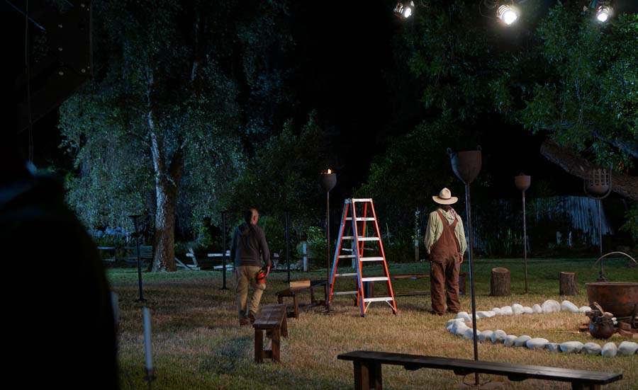

Premium Member David Mullen ASC Posted July 15, 2016 Author Premium Member Posted July 15, 2016 I didn't take photos that included the lighting on set, I just took photos similar to the camera set-up framing out the lights. But I found one that I took as I was setting up the lights for a night exterior in a large backyard where you can barely see the lights at the top of the frame. This location didn't allow me to backlight the space but I didn't want to front or side-light this only, I wanted the lighting to radiate from the center of the backyard where the ceremony takes place. So we used an articulating condor (I think a 60' arm, maybe 45') and we hung a speed rail frame so I could create a ring of lights (1K's mostly, maybe tweenies) pointed down and out slightly, with one light in the center pointed straight down over the fire. Again, since I was lighting to get an f/2.8 at 100 ASA, it was quite bright, deliberately a bit overlit. The background had a rake of daylight HMI's or daylight LED fresnels, plus one low backlight behind the big tree. The black shape in the foreground is the base of the condor, which was right next to the camera when we shot, armed out into the center of the backyard. A frame from dailies (I blurred the nudity a bit in this jpeg): The house attached to this backyard was just off-camera to the right, with some banquet tables, so I established some white light spilling from the house onto the ceremony from that direction. The opposite direction I had the blue moonlight rake.

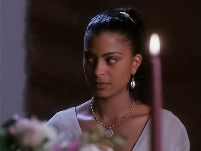

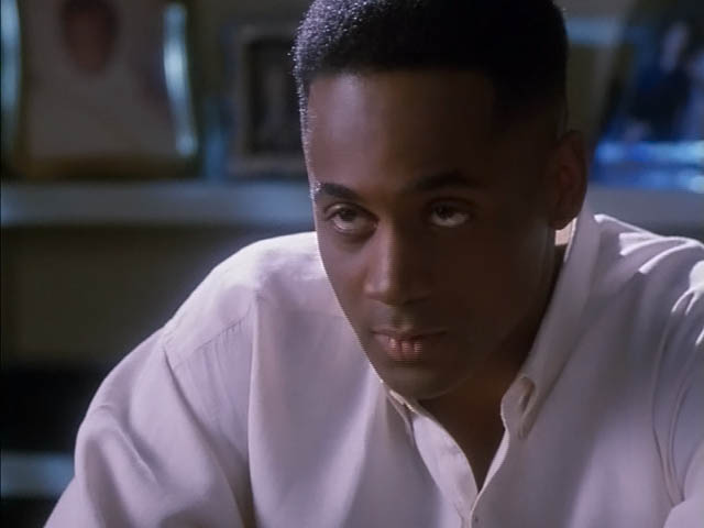

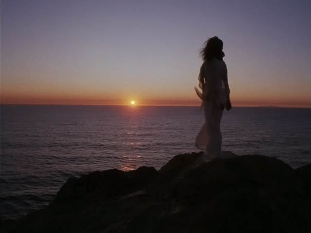

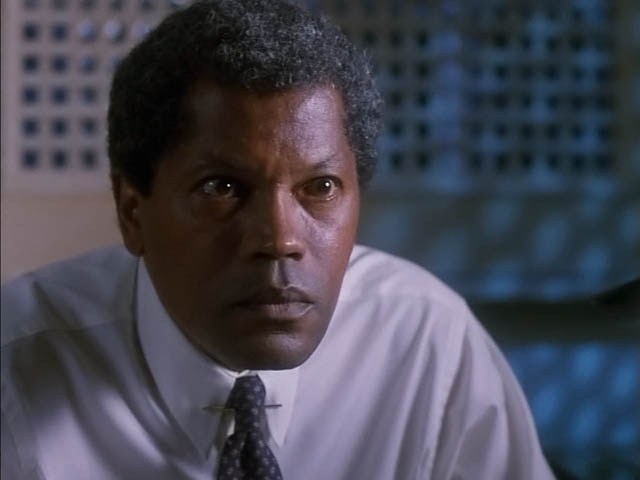

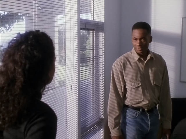

Premium Member David Mullen ASC Posted July 21, 2016 Author Premium Member Posted July 21, 2016 I did two features on Agfa XTR250 and XTS400, both ultra low-budget. Only one is on DVD, titled "Ritual", and it's only a 4x3 interlaced-scan telecine transfer: https://www.amazon.com/Ritual-Clarence-Williams-III/dp/B0002IQGQW The subject matter is fairly controversial, involving incest and it has some male nudity. It was shot in 15 days in an all-white mansion in Malibu with an all-black cast, with a monochromatic production design, so the Agfa stock seemed like a good option. Trouble is that the movie was so low in budget that it ran out of money in post and sat unfinished for more than five years, so even though it was shot in 1993, it wasn't released until after 2000. It was only my third feature. Some frames from the DVD: The overexposed Agfa stock actually printed quite well on to Vision print stock, which didn't exist when we shot the movie. The print timer was quite impressed by the contrast and colors, kept asking me what stocks I had used. Agfa stopped making color negative movie stocks just a year after I shot the movie, after they had just released these new stocks.
Todd Anderson Posted July 22, 2016 Posted July 22, 2016 David, Thank you for posting the Agfa stock frames. I just ordered a used copy of the DVD on Amazon. The lighting looks amazing and very naturalistic. No doubt the monochromatic production design / color pallet is subconsciously making me make it feel lower contrast, but it does seem closer to how I view the Fuji Eterna stocks. Though, I see your mention of overexposing, so I assume that is playing a part in contributing to that sort of milky / slightly ‘flashed’ look I perhaps see, too (non-telecine related color / contrast shifts, notwithstanding, of course) Perhaps, the only benefit from the film sitting for five years is that you eventually got a DVD release versus a VHS for your personal library. But I imagine it must be frustrating having to wait that long when the whole crew put in such an effort and could have likely used everything for their respective reels. For the DVD, was the 4x3 just a ‘open matte’ transfer from 1.85 center ’academy’ framing? And in those days, would they have even asked you if you would have liked to sit in on the DVD / telecine transfer? Thanks again for sharing. — T
Premium Member David Mullen ASC Posted July 22, 2016 Author Premium Member Posted July 22, 2016 Yes, I think it's an open matte transfer - I shot it in 4-perf 35mm framed for 1.85 for a photochemical finish (D.I.'s were not an option in the 90's.) After the answer print was made, a color-timed IP was struck for telecine transfer, though I suppose it is possible they used a low-con print, which was still being done back then. The movie was shot with a light ProMist filter, which accounts for a little of the milkiness, combined with the Agfa stock. I used to keep notes in a journal about everything I shot after film school. Here is what I wrote in December 1994 (not 1993, I was mistaken): -- 35mm, Arri-BL4S (Clairmont Cameras), Zeiss Super-Speeds, Agfa stock -- Used Agfa XTR-250 (rated at 160 ASA) for everything except low-light night work. -- Used Agfa XTS-400 for low-light work. -- Used 1/4 ProMist on everything except when under a T/2.0, then used a 1/8 ProMist. -- Because of video dailies, not sure if XTR-250 w/ 1/4 ProMist will look too grainy on big screen. -- Used LLD filter (instead of 85) for daytime interior work. -- Used 1/4 Coral filter to warm up scenes, had to write "Golden Tint" on slate after grey scale to keep lab from timing warm effect out. -- XTR-250 with no filters looks like 5293 (EXR 200T). With diffusion, works best in contrasty lighting -- NOTE: In January 1995, Agfa Corp. announced they would no longer be manufacturing color negative film. David Watkin must have hoarded some of the stock because he managed to shoot most of Franco Zeffirelli's "Jane Eyre" (1996) on Agfa XT-320.
