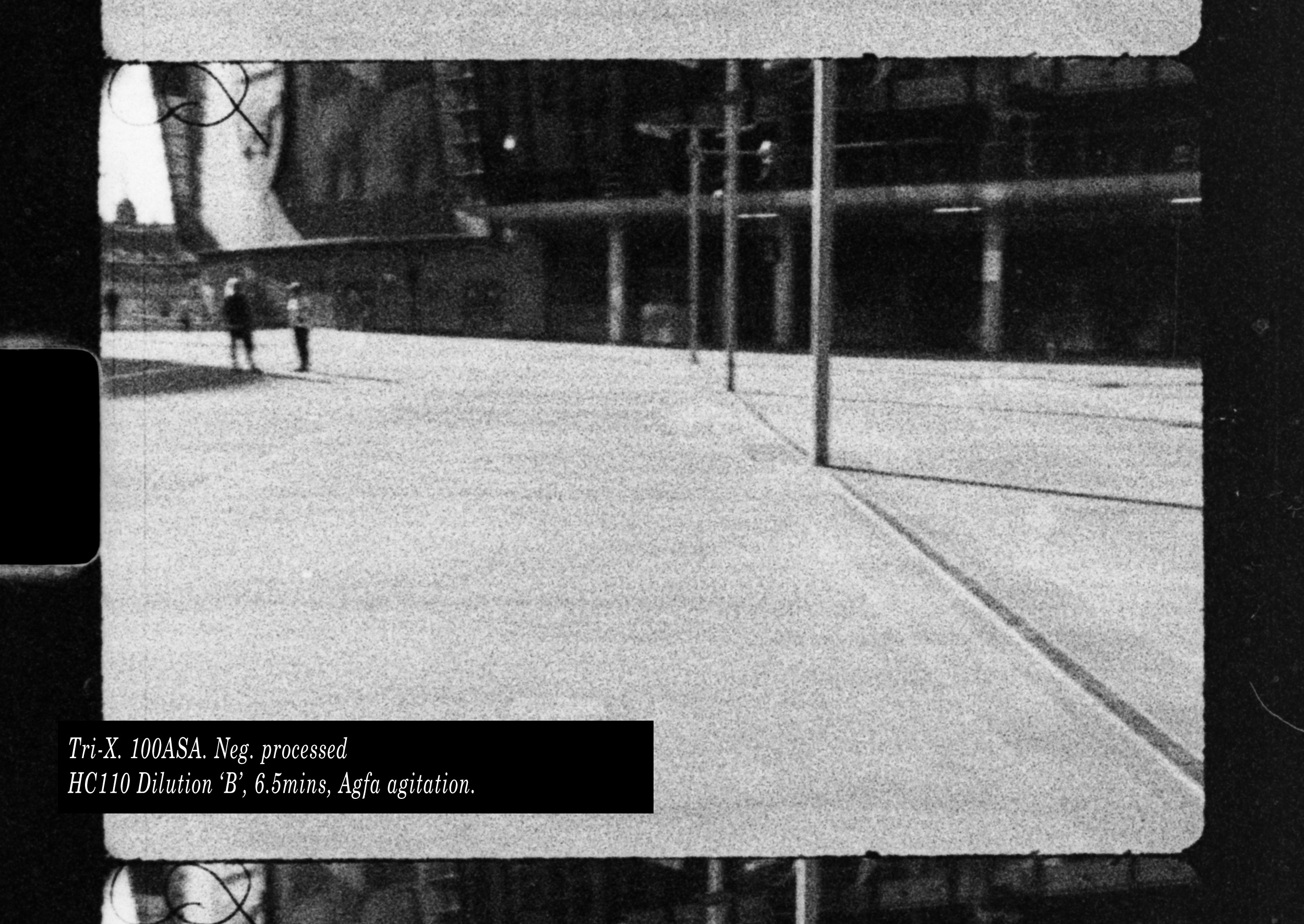

Simon Lucas Posted October 4, 2015 Posted October 4, 2015 (edited) Photoshop levels applied to boost blacks, gentle low-pass filter added to increase sharpness. Maybe my best Tri-X test so far, and a good alternative to the previous gritty Rodinal (APH09) look. I like the poetry in this frame. Out of focus, perhaps due to the fact it is a hand-held panning shot, made in haste whilst the sun broke through he clouds. Of course HC110 is cheap and has a long shelf-life. My sealed glass bottles are now over 2 years old. Note. Pan X in HC110 lacked compared to APH09, so this is a nice surprise. Next up will be D19, later in the week, But maybe it will be hard to match this. Edited October 4, 2015 by Simon Lucas

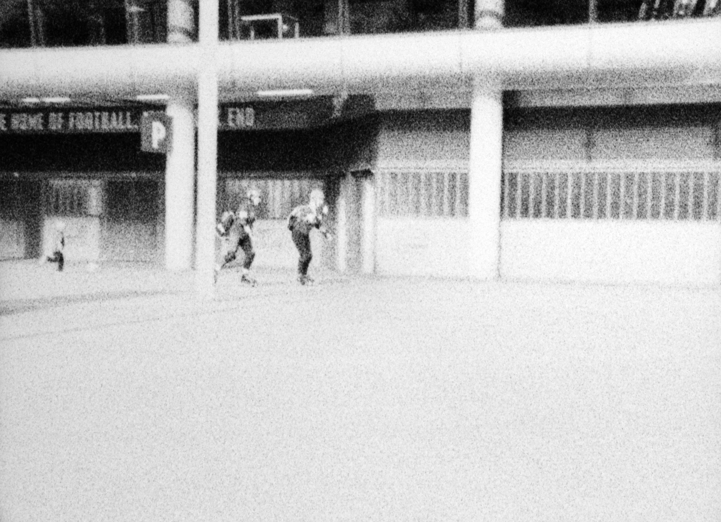

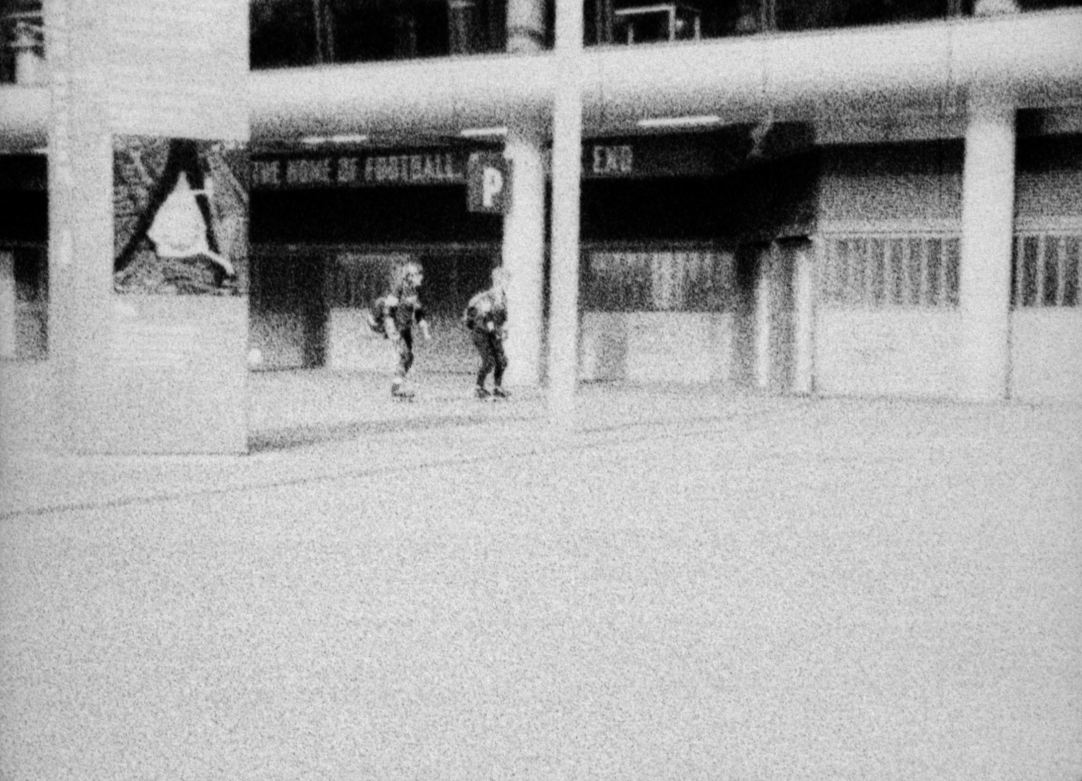

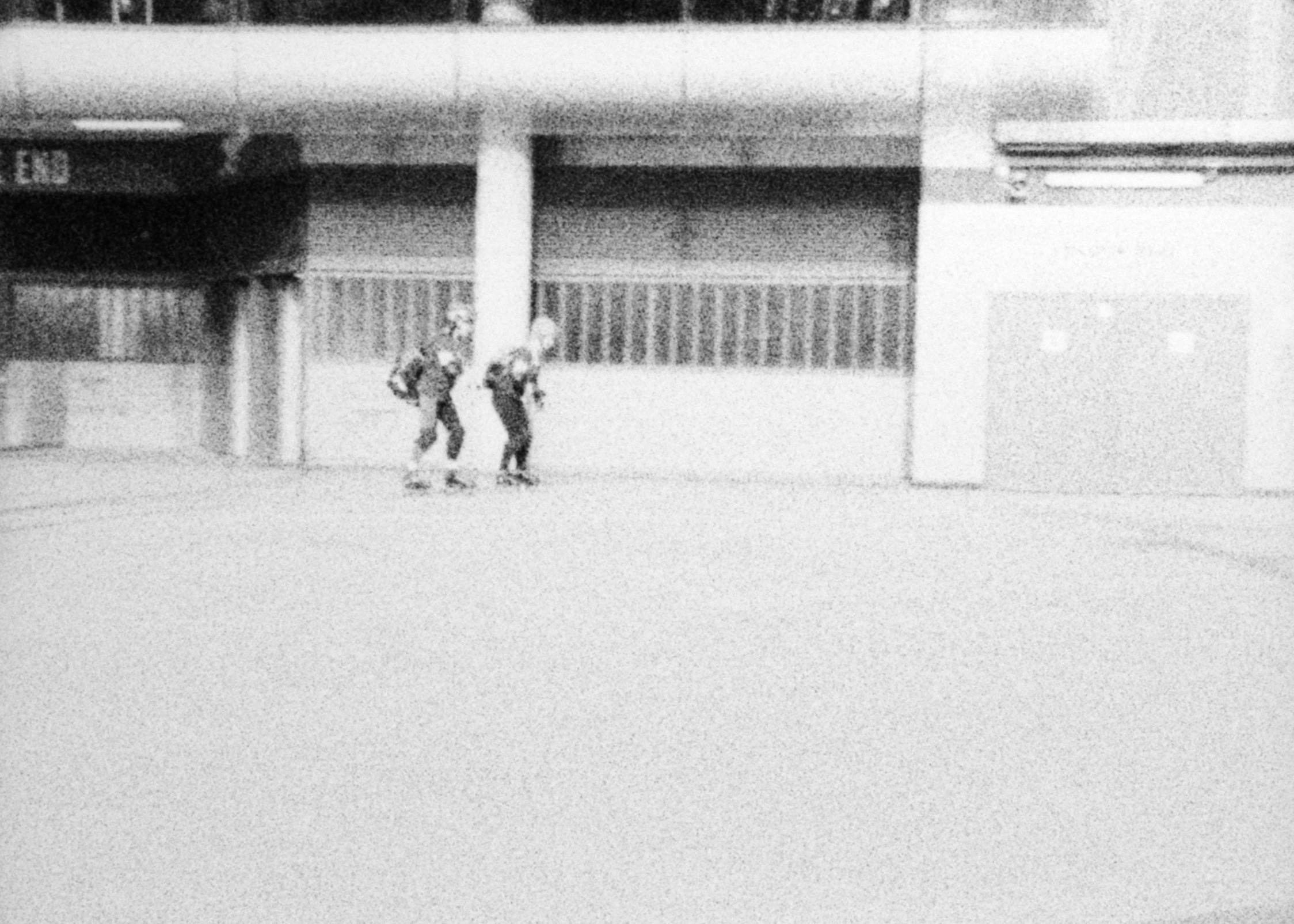

Simon Lucas Posted October 14, 2015 Author Posted October 14, 2015 (edited) Here's some TX, rated at 100asa, processed in D19. Photographer's Formulary D19 suggests times starting at 9 minutes* for this very active developer. But the 9 minutes which I started with gives very dense negs, so I eventually worked down to a potentially adequate 3.5 minutes. All are usable with adjustment in photoshop. The longer times give more contrast, although the dense 9 minutes neg has become very grainy and requires considerable adjustment. I think the main difference between this developer and the HC110 or APH09 developed films is a large increase in overall contrast, with much better blacks in the neg. (*I wonder whether the 9m starting times are aimed at reversal processing?) 9 minutes: 6.5 minutes: 4.5 minutes: 3.5 minutes: Edited October 14, 2015 by Simon Lucas

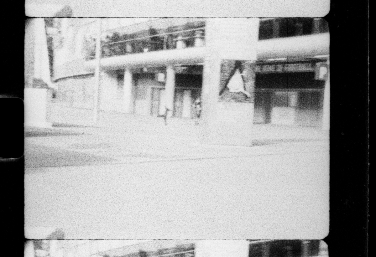

Simon Lucas Posted November 1, 2015 Author Posted November 1, 2015 (edited) I wanted to see if I could reasonable results pushing Tri-X for indoor shooting. Push processed Tri-X. 11 mins D19. Taking in as RAW and then levelled to even out the 4 variant images. First levelled versions, then unprocessed. Tungsten lighting. Edited November 1, 2015 by Simon Lucas
