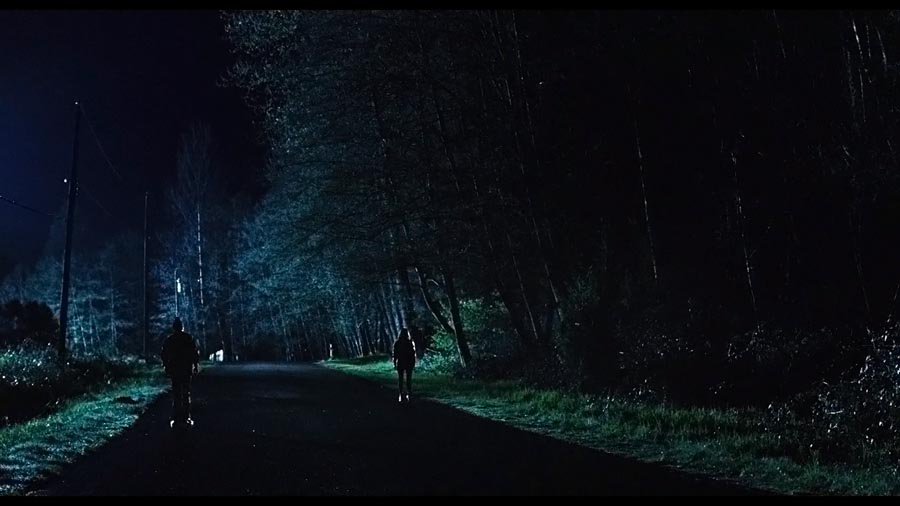

Premium Member David Mullen ASC Posted November 28, 2015 Premium Member Posted November 28, 2015 I lit a big stretch of road with two 18K HMI's on a 125' condor, but at that distance, the lights weren't high enough to get out of frame, but luckily the road had a bend in it, so the condor ended up just off camera on the left side of frame. I ended up hiding a little HMI Joker in the bushes on the right to create a cross-edge, just because otherwise I couldn't make out the figures clearly. I asked for the road to be wet down, but once the truck passed through, the water made the road pitch black! Because the backlights were more from the side, I didn't get a kick off of the road from them that I expected, so in the end, perhaps it would have been better to leave the road dry and dusty, though the blackness is sort of creepier:
Jeff L'Heureux Posted November 28, 2015 Posted November 28, 2015 That's the perfect lighting for a night exterior. It's lit, stylistic, but looks entirely natural to an average audience member. I'd much prefer seeing a film shot like that with some 500T film rather than footage in available light on some new fangled digital camera at a high ISO setting. Maybe it's not happening in forest scenes, but it looks like it's going that way a lot for urban/city night exteriors. With available light, you lose this controlled, crafted look of cinematic lighting.
Robin R Probyn Posted November 28, 2015 Posted November 28, 2015 (edited) Well I dont know.. a scene that would in reality be pretty much,if not pitch black very dark.. any lighting is not really natural.. and its not blue either.. but that is now part of cinema grammar .. and audiences are used to night/moonlight being blue and back lit.... La Nuit Americaine :) I really like The Wolf man look.. although its a totally un natural light source .. being low like that.. but a great moody look.. I read about a DP who was once asked .. where would the light come from in a night scene.. and he said same place as the music .. :) Not to say Dave,s lighting is not good !.. just that I think you can get away with "un natural" lighting at night for a look you are after.. as in the those stills .. Edited November 28, 2015 by Robin R Probyn
JD Hartman Posted November 28, 2015 Posted November 28, 2015 (edited) Well I dont know.. a scene that would in reality be pretty much,if not pitch black very dark.. any lighting is not really natural.. and its not blue either.. ....... Not to say Dave,s lighting is not good !.. just that I think you can get away with "un natural" lighting at night for a look you are after.. as in the those stills .. Where would it come from? Sunlight reflected off the moon, unless it it was the dark of the moon. Even in that case, there would be some light, some light pollution from nearby buildings, streetlamps, towns, etc., unless you were in a very deep forest or an area designated as Dark Sky: http://darksky.org/idsp/ "Real" moonlight is silvery. Edited November 28, 2015 by JD Hartman
Robin R Probyn Posted November 28, 2015 Posted November 28, 2015 (edited) Yes well the brief was a muddy road in a forest with trees all around.. and yes I know where moon light comes from.. if there is a enough moon and no clouds.. but that light never looks like "movie" night.. its not backlight the whole time.. not blue.. But my point is that I dont think it has to be "natural" anyway..as in all the pic,s above.. actually I like the low backlit shots.. totally un natural but looks great.. and sets a mood.. which is what lighting is all about ? Edited November 28, 2015 by Robin R Probyn

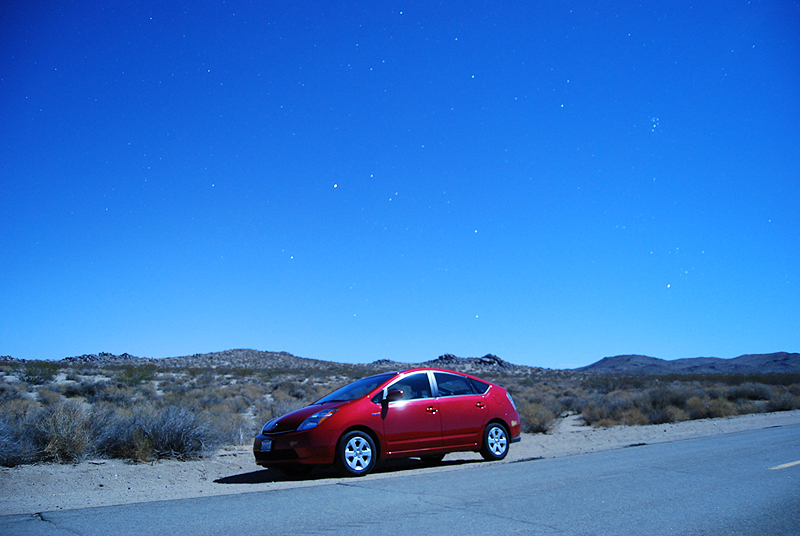

Premium Member David Mullen ASC Posted November 28, 2015 Premium Member Posted November 28, 2015 These are two photos I took of my car years ago in actual moonlight: Underexposed three stops with the camera set to 3200K: Not underexposed: The moon is a big sharp daylight-balanced light in the sky that produces hard shadows. It can be coming from a back, front, side, or dead overhead angle just like the sun. Movies tend to keep it to a backlit angle to maximize the amount of shadows the light creates in an open space. How dark it is depends on how dark you expose for it. How blue it is depends on the color temperature setting of the camera (because of our eyes adjusting to the color and the fact that our cones work less well in dim lighting, the moon seems silvery rather than blue, but it is definitely cooler than tungsten sources in the landscape). When I was out in the desert that night, the moon was quite bright, it felt like I was in a bad day-for-night scene in a movie. The thing is that half of what we do for scenes at night with no practical source other than the moon is just to see the screen action. It may be "unrealistic" but of the director says that the audience won't see what is going on, can't see the performances, etc. then you're going to have to add more light or exposure. Now in the case of my movie, we were referencing 1980's horror movies, which had a lot of blue HMI night lighting in them. I could have easily timed it more grey-ish silver in the D.I. 1
