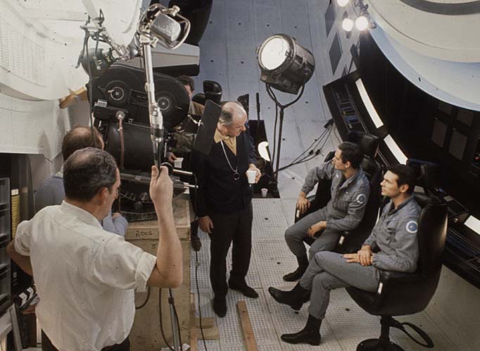

Premium Member David Mullen ASC Posted December 5, 2015 Premium Member Posted December 5, 2015 http://oneperfectshotdb.com/news/the-ultimate-trip-100-rare-behind-the-scenes-photos-from-stanley-kubricks-2001-a-space-odyssey/ Some great photos of the sets being shot. I've always been fascinated about how fluorescent lighting was often faked with large tungsten units or globes hidden behind frosted panels back in the days of 50 ASA film in the 1960's. The photo of the lighting set-up in the centrifuge set suggests that Kubrick wanted any additional lighting to be bounced - you can see some large mushroom globe bulbs in reflector housings bouncing into white cards, but I suspect in the end, Unsworth had to roll in two 10K's to augment the bounce further for this set-up.
John Holland Posted December 6, 2015 Posted December 6, 2015 Interesting a Mitchell BFC 65mm which sort of confirms that Todd-AO lenses were used on this .And then on the high shot with the 2 x 10K's a Panavision 65 mm .
Premium Member Tyler Purcell Posted December 6, 2015 Premium Member Posted December 6, 2015 I think the Mitchell was used for the 35mm insert shots of their discussion which are square. That's my thought on why that camera was there.
John Holland Posted December 6, 2015 Posted December 6, 2015 Maybe but I think it would have been easier to shoot everything in the same format .I don't know wish I did hope someone else knows .
Premium Member Tyler Purcell Posted December 6, 2015 Premium Member Posted December 6, 2015 Well, they did use Todd AO lenses on it for sure. They also absolutely used Mitchell cameras, almost all of the BTS images from the end of the film in that white room, are of Kubrick with a Mitchell body, same with the centrifuge scene. Maybe I'm mistaken about which shot that is... maybe it's the bug-eye shot of Hal looking back at the two of them? Which would be a Todd AO bug-eye lens. You could be right, the insert of the screen could have just been taken from a 65mm interview.
Premium Member David Mullen ASC Posted December 6, 2015 Author Premium Member Posted December 6, 2015 Todd-AO 65 and Super Panavision are the same format, so I'm not surprised if a mix of cameras were used. I'm sure 16mm and 35mm were used for some material to be projected onto screens, plus tests. Kubrick was also well-known for adapting still camera lenses and I think some medium format lenses that he found were put into use for some shots. I'm surprised there weren't more use of Coops, Fay globes, and PAR64's, etc. but maybe those units were just starting to arrive in the U.K. studios at the time.
John Holland Posted December 7, 2015 Posted December 7, 2015 I have never seen that still with the Todd-AO camera and Bug Eye lens thanks .
Mark Dunn Posted December 7, 2015 Posted December 7, 2015 (edited) I don't think the top one is a BNC- is it a BFC with the mag blimp off? Or maybe as this was the first scene to be shot they hadn't got round to putting the Panavision stickers on. Edited December 7, 2015 by Mark Dunn
KH Martin Posted December 7, 2015 Posted December 7, 2015 Kubrick was also well-known for adapting still camera lenses and I think some medium format lenses that he found were put into use for some shots. Jon Alcott, who shot DAWNOFMAN and the whiteroom stuff under the credit of additional photography, used his own Nikon still lenses when it came time to do model photography on DISCOVERY and other ship miniatures. And the photocutouts that were animated for many space scenes were shot using Hassleblads, so the resolution of the photo cutouts would be equal to or superior to the taking-65 cameras. I'm pretty sure most if not all of the RP stuff played back on live-action sets was shot in 35, then reduced to 16 for projectors. RP stuff for the model shots I'm guessing would have been 65, otherwise you'd be undercutting your own credibility.
