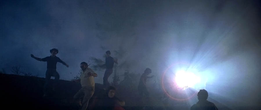

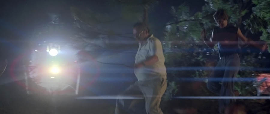

Premium Member David Mullen ASC Posted July 25, 2016 Premium Member Posted July 25, 2016 Both "Blade Runner" and "Close Encounters" mixed 65mm spherical and 35mm anamorphic, and in some scenes, you get both types of flares, like this one in "Close Encounters": 65mm 35mm anamorphic The 65mm camera angle has no visual effects work done to it -- this may have been a case where they were doing a stunt with a helicopter and Spielberg decided to roll his 65mm camera on it alongside his 35mm cameras. The thing to remember is that the red ring is a circular flare in both formats, it's just then when the image is expanded horizontally by 2X to get rid of the anamorphic squeeze, the red ring becomes a flattened oval.
