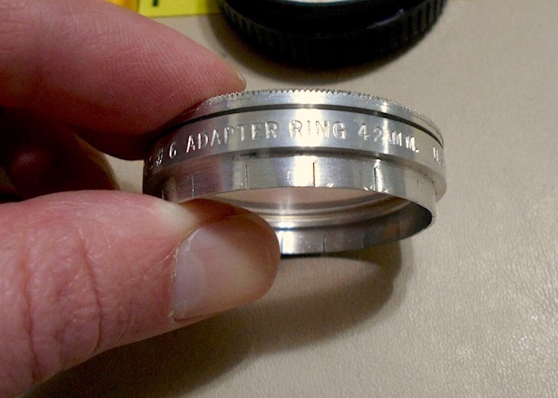

David T. Nethery Posted August 18 Posted August 18 (edited) On 6/14/2005 at 5:14 PM, Guest Ian Marks said: The Angenieux 10mm does not have filter threads, which I find quite annoying. The other Angenieux lenses in the range (15mm, 25mm, 50mm, and 75mm) all take the same hard-to-find Series 5.5 filters via a threaded retaining ring. Old topic, but for anyone now or in the future searching for a solution to this problem: Search on eBay or at photography stores with a supply of vintage camera equipment for a Slip-On filter retaining ring, which goes around the outside of the lens. The outside diameter of the Angenieux 10mm is slightly is about 41.7mm so a slip-on retaining ring of 42mm or 42.5mm or even 43mm should work. (43mm may be slightly loose, so add a strip of teflon tape to the inside rim of the 43mm slip-on ring) Then find a set of vintage Series VI (6) drop in filters. The drop in filters are held in place by the slip-on retaining ring. Edited August 18 by David T. Nethery

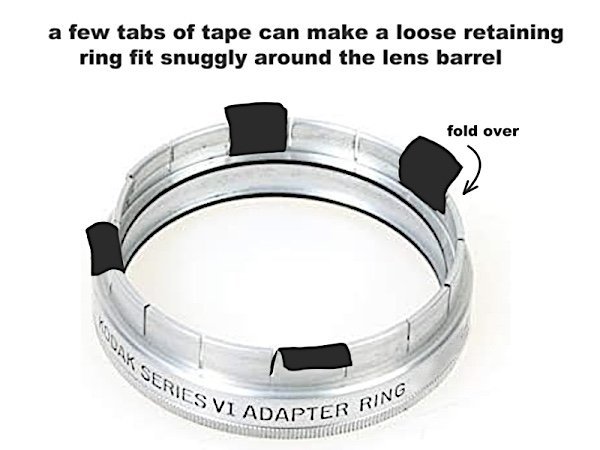

David T. Nethery Posted August 22 Posted August 22 (edited) On 8/18/2026 at 3:46 PM, David T. Nethery said: Old topic, but for anyone now or in the future searching for a solution to this problem: Search on eBay or at photography stores with a supply of vintage camera equipment for a Slip-On filter retaining ring, which goes around the outside of the lens. The outside diameter of the Angenieux 10mm is slightly is about 41.7mm so a slip-on retaining ring of 42mm or 42.5mm or even 43mm should work. (43mm may be slightly loose, so add a strip of teflon tape to the inside rim of the 43mm slip-on ring) Then find a set of vintage Series VI (6) drop in filters. The drop in filters are held in place by the slip-on retaining ring. Addendum to above: I re-measured the Angenieux 10mm lens and it really needs a 41mm slip-on filter retaining ring for a snug fit, the 42mm slip on retaining ring is too loose. 43mm is much too loose. (but as mentioned, a few tabs of teflon tape or gaffer's tape folded over the inside edge of the slip-on retaining ring can help make a loose fitting retaining ring fit more snuggly, but better to just use a properly sized ring to start with so you don't have to mess with the tape. ) Edited August 22 by David T. Nethery
