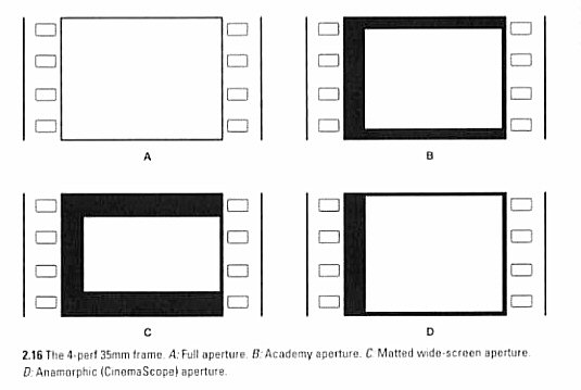

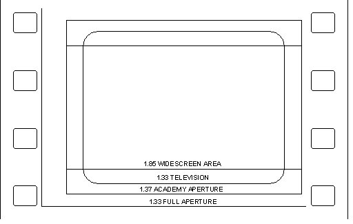

Dominik Muench Posted June 21, 2005 Posted June 21, 2005 excuse my question if thats stupid, but whats the difference between a super35mm and a sound aperture ? whats the aspect ratio got to do with sound ? apart from the magnetic strip on the side ?
J. Lamar King IMPOSTOR Posted June 21, 2005 Posted June 21, 2005 (edited) If you've shot enough 16mm there isn't any reason to get wigged out over shooting 35. This is when you'll grow to love your AC's. Of course you should do some testing if you're able, especially if you're going to be shooting scope. BTW, a Super35 gate allows an image to be exposed on the area of the negative which is usually left unexposed with a sound aperature. It's left unexposed because that is where a sound track goes on a print. This is why Super35 requires an optical or DI step to anamorphize the image so it can be printed with a soundtrack. Edited June 21, 2005 by J. Lamar King
Premium Member David Mullen ASC Posted June 21, 2005 Premium Member Posted June 21, 2005 First of all, most 35mm cameras EXPOSE Full Aperture (Silent / Super-35), although some may have a smaller gate that only exposes Academy Aperture (Sound). But the real question is whether your lens is optically centered for Full or Academy. If it is centered for the sound apertures (Academy / 1.85 / anamorphic) then the Full Aperture area isn't really meant to be used -- there's probably some vignetting, and the groundglass is set-up for you to compose within the Sound aperture anyway. Super-35 doesn't necessarily mean a D.I. or even a conversion to 2.35 anamorphic. TV shows, for example, shoot Super-35 for telecine only. This means they expose and frame across the Full Aperture width, beyond the sound aperture area, and the lens is optically centered for Full Aperture. For theatrical movies, the most common use of Super-35 is to compose for cropping top & bottom to 2.35, and then convert the image (optically or digitally) to 2.35 anamorphic. But some Super-35 movies have been composed for 1.85, in which case you'd have to reduce the image (optically or digitally) to the standard 1.85 format that exists inside the smaller Academy Aperture. In 35mm, Full Aperture is the largest area you can use, with the image extending from sprocket row to sprocket row horizontally, and the top & bottom edges touch the next picture with a very thin frame line separating them. In 4-perf, Full Aperture is 1.33 : 1 and was what was used in the Silent Era. Super-35 is essentially Full Aperture. In 3-perf, Full Aperture is 1.78 : 1 (16x9) which is why 3-perf is popular for TV shows transferring to HD. Then when sound-on-film was invented (Fox Movietone), they used up a strip along the left edge of the print inside the sprocket row for an optical soundtrack. The optical center of the camera lens had to be shifted over. The width of Full Aperture was shaved from 1.33 : 1 to a square-ish 1.20 : 1 more or less. This was called the Movietone Aperture. In 1932, AMPAS suggested that the projector gate that was masking off this soundtrack stripe from appearing on screen also mask a little off of the top & bottom, further shrinking the area used on the print, but making the shape less square, more rectangular, to 1.37 : 1. This is called Academy Aperture. Later, they cropped the top & bottom much more to create the widescreen 1.85 shape (and others like 1.66). This is called Matted Widescreen. There is also Anamorphic Widescreen (CinemaScope). Anyway, a camera can be ordered for Super-35 (Full Aperture) or for regular Academy / 1.85 / anamorphic aperture. Usually the gate is left to expose Full Aperture either way (knowing that a sound print will cover over part of this with the optical track), but the lens center is shifted over depending on which you choose, and a matching groundglass is installed. If you are shooting 35mm for contact printing and projection (not optical printing or D.I.) then your choices for 35mm theatrical projection are the 4-perf 35mm standard 1.85 matted widescreen format using spherical lenses or 35mm anamorphic using anamorphic lenses on the camera. If you shoot in Super-35 but want a projection print eventually with a soundtrack, you'd be stuck doing some sort of conversion to one of these two standard projection format, either using dupes and an optical printer, or a D.I.
J. Lamar King IMPOSTOR Posted June 21, 2005 Posted June 21, 2005 See you learn something new everyday. I thought for contact printing the gate had to block the sound area. Is that not the case?
Premium Member David Mullen ASC Posted June 21, 2005 Premium Member Posted June 21, 2005 No, the soundtrack area is masked off when making the print; the negative can have picture exposed there, it's just not used. Here are some charts, the first from my Cinematography book, the second is just something I drew of some standard 4-perf 35mm sound aperture framelines:
