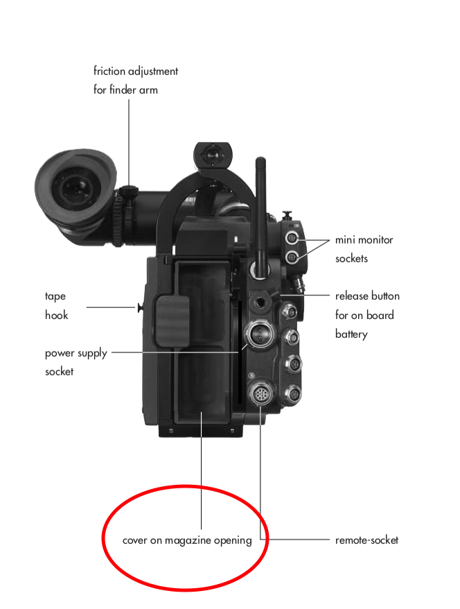

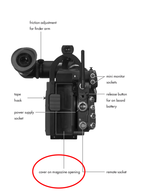

Leyna Rowan Posted April 3, 2019 Posted April 3, 2019 In search of spare parts for Arri 416. Specifically the magazine opening cover on the body. Photo attached below. Does anyone have experience 3D printing these simple, yet immensely important plastic parts to cameras? Any leads appreciated.
Premium Member David Sekanina Posted April 3, 2019 Premium Member Posted April 3, 2019 (edited) The covers for the fisher connector you can find at fisher connector: https://www.fischerconnectors.com/switzerland-en/en concerning the mag opening cover: if you can send me the part for a few days i can measure and model it and put the 3d model on shapeways, where you could order it in strong and flexible plastic (SLS polyamide 12) with premium finish (vibration grinding) for a smooth surface (otherwise some of the non sintered polyamide powder still remains on the part, rubs off and gets into the camera (not good). cheers david Edited April 3, 2019 by David Sekanina
Yuya Killian Kudo Posted December 4, 2025 Posted December 4, 2025 Hi, I'm actually in the same pickle - I'm in dire need of (1) Magazine Opening Cover and (1) Magazine cover for the Arri 416. @Leyna Rowan, did you have success anywhere? Did you end up 3D printing it? @David Sekania, are you by any chance still open to printing it? I'm based in NY. Any help would be much appreciated. Thanks!
