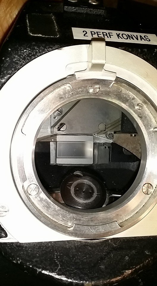

victor huey Posted December 1, 2019 Posted December 1, 2019 (edited) I have been trying to configure a 2 perf Konvas on a clone steadicam, but i am at the weight limit of the arm? Edited December 1, 2019 by victor huey
