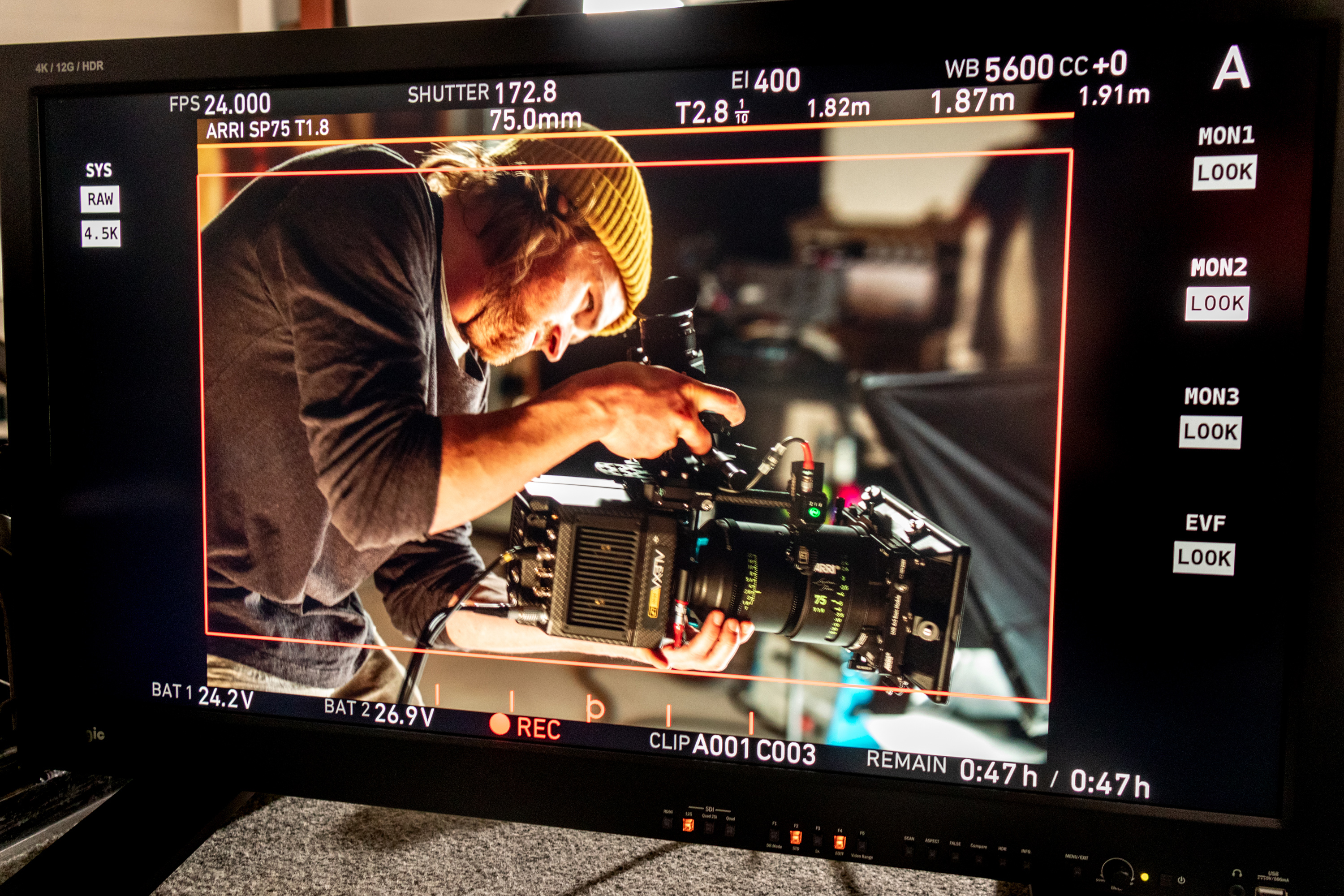

Dan Hasson Posted October 21, 2019 Posted October 21, 2019 On the special features, was the footage the people were viewing on a monitor that looked like this? Notice on the left side there is a grey box thats says RAW. This shows the camera is recording to RAW. On the right side there are four grey boxes that say LOOK. Say the monitor in the image is MON1. So they have applied a LOOK to be outputted to MON1 for on set viewing. So for the film you were watching, most likely the DP (and sometimes with the DIT) would have either chosen a pre-existing LUT (LOOK) or they would have made their own. That would explain the 'film look' you would have been seeing for the films on set monitors. You can make your own LUT's on DaVinci, export it as .cube, then via Arri's USB (that usually comes with the rented camera) and the programme Arri Look Creator you can put it in the camera to be used for on set monitors. Hope that helps. Dan
