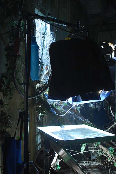

Premium Member David Mullen ASC Posted May 11, 2020 Premium Member Share Posted May 11, 2020 We had several pans with glass bottoms and mirrors below that had a tube dripping water into the pan with a light pointing down at it (I think blue-gelled blonde or redhead or something) but the best effect came from skipping a 1200w HMI PAR off of the pool surface itself, creating much bigger and sharper ripples. 1 Quote Link to comment Share on other sites More sharing options...
