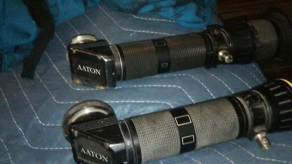

Bob Dorsey Posted June 21, 2020 Posted June 21, 2020 Brody, I have an Aaton zoom extension eyepiece available. It has a built-in heater diopter and a male bnc for the eyepiece follower rod. I'm try to find the cable to the heater and the follower rod assembly. 1
Robert Dorsey Posted June 21, 2020 Posted June 21, 2020 I have Two extension eyepieces with zooms available. They both have a BNC mount for an eyepiece follower (removable). One has a built-in eyepiece heater. I also have available diopters to further the range of the standard diopter adjustment.
Robert Dorsey Posted June 29, 2020 Posted June 29, 2020 Aaton ZOOM extension eyepiece with follower. $ 980
