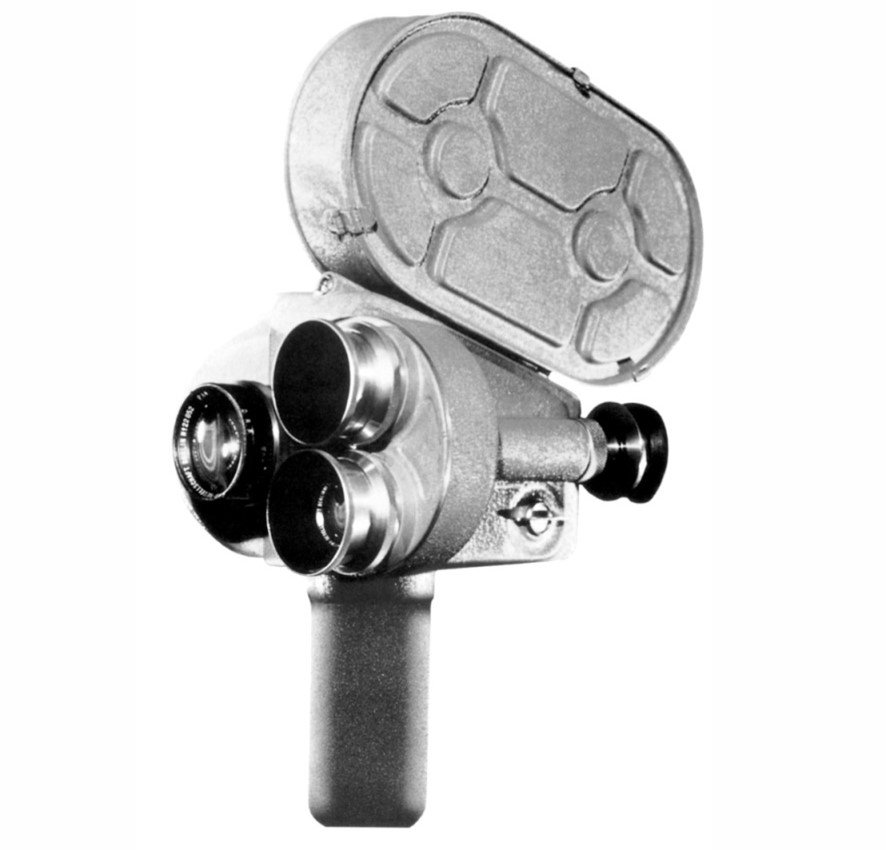

Aren Madsen Posted June 4, 2021 Posted June 4, 2021 Hi, There's only a few posts that seem to mention the Cineflex, a US Army copy of the Arri 35. Has anyone here used one before? Is the movement inside more or less the same design or is it quite different and can it take magazines bigger than 400'? I'm also curious about how it performs, would it have good, stable registration? Any information would be much appreciated. Thank you
Premium Member Frank Wylie Posted June 5, 2021 Premium Member Posted June 5, 2021 (edited) I only handled one briefly in the late 1980's, but didn't shoot with it. It's more or less a direct rip-off of the original Arri 35 that was recovered from a shot down Axis bomber. As I understand it, the magazines are interchangeable between the two cameras, but not sure about anything else. In retrospect, it kind of reminds me of the build quality of a Konvas, but not quite as good. Edited June 5, 2021 by Frank Wylie 1
Premium Member Dom Jaeger Posted June 5, 2021 Premium Member Posted June 5, 2021 One of the forum members here was selling their Cineflex a couple of years ago, with pictures that show how similar it is to the Arriflex 35 it was based on: https://cinematography.com/index.php?/topic/79386-for-sale-cineflex-a5-35mm-arri-35-clone/ My understanding is it was a very close copy, although being American it would have Imperial measurements rather than than metric, so the lens mount and mag throat dimensions would be different, meaning it is not compatible with Arriflex lenses or mags, though I do recall reading somewhere that people had successfully modified Arriflex mags to work with a Cineflex. The main other difference is that the motor is attached to the side of the camera rather than the bottom. In the post war years, Arriflexes were much more popular than Cineflexes, and considerably more expensive, which leads me to believe that a Cineflex may not have been as well made as an Arriflex. The movement is based on the first Arriflex movement, a simple eccentric cam, which was not as stable as the improved cardioid cam design that Arri introduced in the 50s. So a Cineflex, like those early Arriflex 35s, is really more of a collector’s piece than a good working camera, given how many Arri 2Bs or 2Cs there are out there. Finding lenses in Cineflex mount is also much harder than finding Arri mount lenses. 2
Premium Member Simon Wyss Posted June 5, 2021 Premium Member Posted June 5, 2021 We have no evidence that the CINEFLEX was copied after the ARRIFLEX but rather assertions. Application for US 2,410,962 was filed April 13, 1944. Application for US 2,419,706 was filed September 25, 1943. The two patents were issued to J. Burgi-Contner. Assumed at least three months for the preparation of the earlier application an ARRIFLEX would have to be brought to New York before or during summer 1943. American troops came first in contact with German troops July, 1943. It even seems an ARRIFLEX would need to have been captured by British forces before. A shot down Axis bomber is vague. When, where? If we study the Contner patents we discover a number of features or details not present with the ARRIFLEX. The texts sound strongly Rockwell Engineering Laboratory, if one has already read a few Bell & Howell Co. patents. Questions arise. I don’t believe the purported story. Arnold & Richter may have bought a licence from B. & H. around 1934-35. The ARRIFLEX can also be an Agfa product no longer used after Agfacolor was tested at the Berlin Olympic Games August, 1936. Agfa could then have taken a licence from Chicago in 193? Bell & Howell was not happy with the behind-the-film prism reflex viewfinder that they had applied for in 1924. It appears with the 2709 design in 1932 and with the Akers featherweight camera of 1933. Eastman-Kodak and B. & H. may have agreed upon Kodachrome not offered as 35-mm. motion-picture stock in 1934. Professional cinema had practically no use for KM. B. & H. was free to exploit KM as 16 and 8 by their equipment. The Kodachrome story of Mannes and Godowsky is made up, too, in my opinion. Research is going on. 1 1
Premium Member Dom Jaeger Posted June 5, 2021 Premium Member Posted June 5, 2021 1 hour ago, Simon Wyss said: If we study the Contner patents we discover a number of features or details not present with the ARRIFLEX. Like what? The Contner patent drawings look almost exactly like an Arriflex 35, except for the side motor attachment. Why would Bell and Howell allow a foreign company to licence an obviously superior camera design to their own Eyemo, without manufacturing one themselves, and then wait until the war era to allow a local licence? We already went down this path a few years ago when you suggested early Arriflex 35s had Imperial measurements which proved it was an American design, and I painstakingly measured all the critical dimensions of a WWII era Arriflex and found them all to be metric, indicating European provenance. I don’t think its suspicious that as soon as the Allies captured an Arriflex and realised the superiority of its design, they commissioned someone like Contner, an engineer and cinematographer, to copy and patent it for local manufacture. The interesting and curious thing for me is, that despite having a locally made and patented version available for half the price, in the immediate post-war years in the United States the Arriflex was what everyone wanted. 3 3
