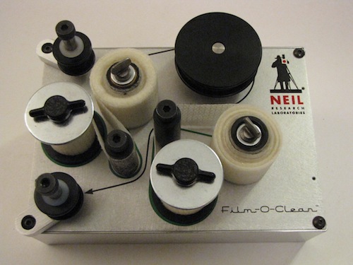

Daniel D. Teoli Jr. Posted February 27, 2022 Author Share Posted February 27, 2022 On 1/9/2022 at 10:39 AM, Dan Baxter said: I think the Neil one is sold here, and you can buy Kelmars as well and convert those to small format. Looks like the film cleaner is extinct. Also, a foreign company. Why can't US companies make an affordable film cleaner?? Quote Link to comment Share on other sites More sharing options...

Daniel D. Teoli Jr. Posted February 27, 2022 Author Share Posted February 27, 2022 (edited) On 1/9/2022 at 9:53 PM, Todd Ruel said: All good. Just looking for another solution. I have a vintage Ecco, but it takes forever to clean a film with that machine. The Film-O-Clean MK 3 on the Wittner-Cinetec site is $1,264, so I'm looking for something less costly (if possible). Can't possibly afford a Lipsner-Smith. Your machine looks very nice! http://8mmforum.film-tech.com/cgi-bin/showpic.cgi?dir=uploads0503&file=EccoFilmCleanersmall.jpg How long does it take to clean? Do you like cleaning by hand with rewinds better? Yes, film cleaning is a pain. http://8mmforum.film-tech.com/cgi-bin/showpic.cgi?dir=uploads0503&file=FOC1small.jpg 8mm Forum: Product Review: Film-O-Clean (film-tech.com) I'm thinking the Film-O-Clean won't handle filthy films. Film is pretty filthy stuff! – Daniel D. Teoli Jr. Archival Collection (wordpress.com) This is from just a few feet of film I deal with. Edited February 27, 2022 by Daniel D. Teoli Jr. Quote Link to comment Share on other sites More sharing options...
Daniel D. Teoli Jr. Posted February 27, 2022 Author Share Posted February 27, 2022 (edited) On 1/10/2022 at 1:18 AM, Robert Houllahan said: Thanks that full set of 7 small and 2 large PTR holders and the Electrostatic brush would push the cost of that bench cleaner I built way over $1200.00 I think the last I looked the larger PTR roller holder pairs alone were $8-900.00 from the now defunct company in Canada that made them. Everything is getting hard to get. FilmFabriek companied they had trouble getting parts. I try to stock up on items if I can afford it. I won't get into politics, but if things escalate in the world and chips are under fire, more than they are now, we will really be screwed. My Epson ink has gone from $55 to $79 per cartridge. It has a big gold-plated chip right on top. And I use 9 of the cartridges. Maybe the next step is... I will have to buy outdated ink on eBay? Jeeesus, what a mess. M-Disc has gone from $2.15 a disc to $3 a disc. And they were hard to get for months. Verbatim discontinued their affordable M-Disc. ($1 per disc.) Maybe their license expired? Right now I need 700 - 800 M-Disc for my VHS archive. All I have is 67. I could never afford to bulk up on them when they were cheaper. I would just buy a few hundred $ worth every so often. Edited February 27, 2022 by Daniel D. Teoli Jr. Quote Link to comment Share on other sites More sharing options...
