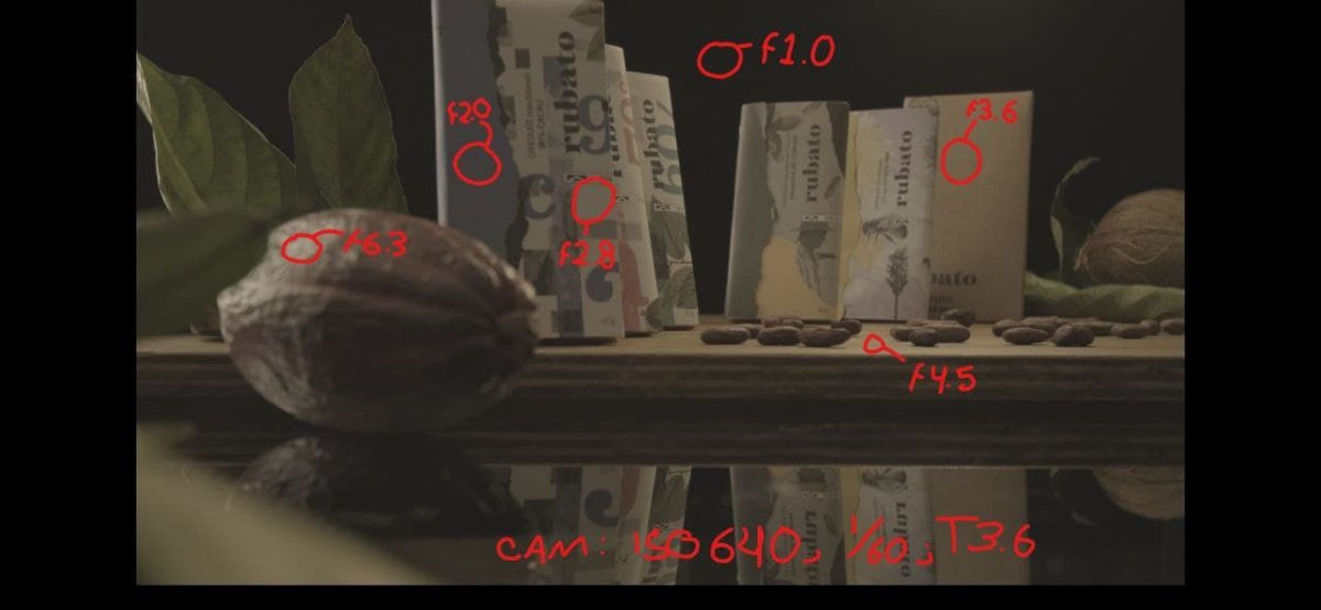

Hey,
Yesterday I was shoting a scene for a comercial and my L858 got me pretty good. I took some measurements with the spot meter from where the camera was (we'll 'rebuild everything later) and I got a underexposed footage (something around 1 stop) following the f3.5  sugested value.
OBS:
- I had some light hitting the spot's lens, but not in frame;
-I tought about recalibrating the meter, but I tried to measure different scenarios around the location and the L858 gave me 3 correct values out of 5. I used waveform to check;
-Last time I used my Sekonic it was perfect.. about a week ago;
-I'm new using lightmeters, so I hope it's just some problem with my interpretation of the situation, lol.
Any suggestion?
Thanks!

1. Done. Using a white card, it matches perfeclty. Using different surfaces (leather, post-its, blue sheets, a cat, etc) it's kinda inconsistent. I've calibrated the l858 to 45% at ISO640 (Fuji XT-3). I've got values between 25-50%.
Quick test: https://drive.google.com/file/d/1djiSs0jfr4ClqLpHmiziN_kJOgdF25Vj/view?usp=sharing
2. Cine Rokinon. The Calibration above was made with this lens.
3. Tried that today. Dark blue sheet lighted from brehind the camera. Got something around 25%.
4. I tried to stay as close as possible to the camera. The test above is the result.
5. That's the thing: is this kinda variation normal and the readings not aways precise? I'm wondering if there's something wrong with my tool 😞. I really hope it's a lack of experience on my part because this I can fix with some pratice, hahaha!
Thanks again!

Not sure you should be spot metering to a white card -- "white" can be any number of luminance values above a certain level.  If you're going to be spot metering a card, it should be an 18% grey card.
Based on your still life arrangement, the closest thing to 18% grey was closer to your f/2.0 reading.

I thought that every surface and color could be measured with the spot and it would be at 45% (or 41%, calibrated for Slog3) if the camera and suggested values were matching. Am I wrong about that?
I'm struggling a little bit to understand the different results I had.
Thank you for all the help and patience!
That makes sense, since those objects are all different exposure values. So you should get different readings.
The spot meter should be calibrated to 18% grey (Sekonic is notorious for calibrating to a different value in their meters, but that is a whole other topic). It assumes that you want to know what exposure to set in order to render the object you are metering at 18% grey on film. Therefore, if you are metering something other than an 18% grey card, your reading will require interpretation.
Let’s say you light a scene with an 18% grey card and a white piece of paper. The grey card meters at f/5.6, 1/60sec, 800 ISO. You meter the white card, which reads at f/16. Then your black cat wanders over and sits on the white paper. You meter her fur at f/1.4. Is your meter broken? No - it’s telling you that your grey card will be exposed correctly at f/5.6, that the white paper is 3 stops over, and your black cat is 4 stops under. Which is fine, you want the paper to look white and your cat’s fur to look black. But if you didn’t meter the grey card first, you wouldn’t necessarily know that.
Based on some Googling, it seems the middle grey target for Fuji F-log is 46%.
If you take readings of the white paper or your cat’s black fur, and set the camera and lens to those settings (and if your camera’s ISO is accurate) - then yes, they should come out at 46% on the waveform, or 18% grey. But then you have to decide if you want white or black objects to look grey? That’s where your interpretation of the meter reading comes into play.
If you want the white paper to look white, then you have to expose it brighter. You could arbitrarily decide that it should be 2 stops over, or 4 stops. But you could be more consistent with your exposures if you first knew how bright the grey card was. Then you have a reference to compare the white paper to. I think the spot meter is more useful this way - having already set your base exposure, you can check how bright the windows are in the background, or how dark the shadows are, and adjust them if necessary.
