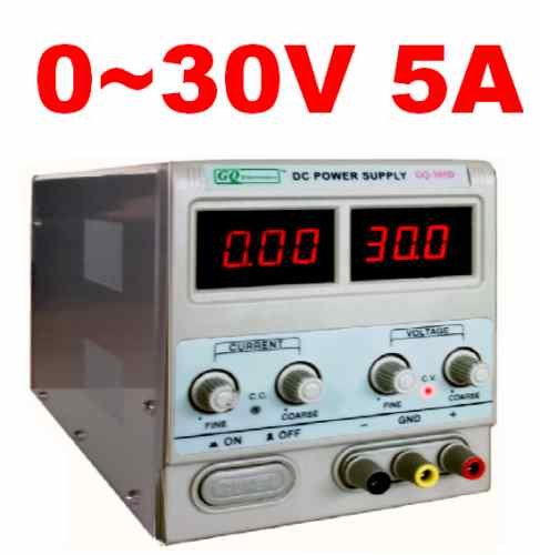

Jonathan Bel Posted September 20, 2011 Posted September 20, 2011 Yes it's me again with my Arri 2C. So I just looked into a 0-30v variable 5 amp DC power supply. My motor is a 16-24v CRA-6A Xtal cine products crystal, 2 amp. Anyway, what it boils down to here is finding a way to connect the XLR cable to the power supply. It's a 3 pin. Here are some pictures. Any bright minds?
Chris Millar Posted September 20, 2011 Posted September 20, 2011 What part of the process are you weary of ? Do you know the pin out of that male XLR ? You know those desktop supplies are real heavy huh ? Also not the most rugged of equipment...

Jonathan Bel Posted September 20, 2011 Author Posted September 20, 2011 The 3 pin XlR I have has a variable speed controller box linked in the middle and then it plugs into my motor. The XLR usually plugs into my 18vdc battery belt. Is there any pigtail adapter I can get for this? If I get a connector like this, wire the positive/negative and link to power supply? will that work? hmmm, Wont a car charger be about 13.6 Volts ? - that cinema products motor needs apparently needs 16-24 Volts ...

Chris Millar Posted September 20, 2011 Posted September 20, 2011 The 3 pin XlR I have has a variable speed controller box linked in the middle and then it plugs into my motor. The XLR usually plugs into my 18vdc battery belt. Is there any pigtail adapter I can get for this? If I get a connector like this, wire the positive/negative and link to power supply? will that work? Hmmm, Don't take this the wrong way - I'd hope youd give the same advice to me - but if this stuff isn't simple to you then best you get it done by someone who knows... If the unit doesn't have reverse input protection you could fry it... Super worst case scenario is a fire :o
