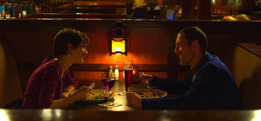

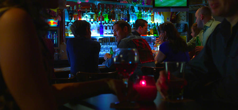

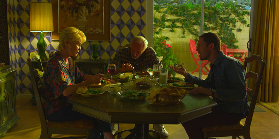

Premium Member David Mullen ASC Posted December 6, 2008 Premium Member Posted December 6, 2008 Sure, you can do your stage lighting all in tungsten on the RED; I'd stick to a 320 ASA rating if you can because the noise problems escalate faster in tungsten mode as you underexpose. Lighting with HMI's in daylight mode would just give you a cleaner look, but certainly the tungsten-lit scenes would be intercuttable. Another option is to use a pale blue filter on the camera in the tungsten-lit scene, if you have enough exposure, for a halfway compromise between 3200K and 5500K. These are some RED frames of scenes shot in tungsten (ignore the heavy JPEG compression):
Robert Gardner Posted December 6, 2008 Author Posted December 6, 2008 Sure, you can do your stage lighting all in tungsten on the RED; I'd stick to a 320 ASA rating if you can because the noise problems escalate faster in tungsten mode as you underexpose. Lighting with HMI's in daylight mode would just give you a cleaner look, but certainly the tungsten-lit scenes would be intercuttable. Another option is to use a pale blue filter on the camera in the tungsten-lit scene, if you have enough exposure, for a halfway compromise between 3200K and 5500K. These are some RED frames of scenes shot in tungsten (ignore the heavy JPEG compression): Hi David, Thanks for the quick reply. Was thinking of using filters or correcting the lights themselves. As you said not sure if there is enough of a budget to compensate for the light loss and get bigger or more lights. It's all more or less low budget. Would you say to use a pale blue filter is better than shooting clean and wait till post? I personaly like to do as much as I can during the actual filming ( my background is more film vs. digi. ) But ja, you recon there isn't a big problem mixing tungsten with daylight in general. Cheers
Premium Member David Mullen ASC Posted December 6, 2008 Premium Member Posted December 6, 2008 It would be simpler to just light all-tungsten and use a pale blue filter -- any amount of blue correction would help a little with the noise in the blue channel. Another option would be to mix HMI's and tungsten and gel the tungsten, or use the tungsten for warm lighting effects. I did this a lot on "Manure", had a daylight base and tungsten units to create golden sunset effects.
