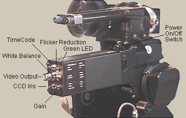

Gerard Dalton Posted October 30, 2024 Posted October 30, 2024 (edited) 9 hours ago, D John Carroll said: Very easy to fit into an LTR modify for various different relay systems in the LTR replace the beamsplitter wafer with 3rd party eBay sources But will the LTR body look exactly like this or will the video assist module need to be put in a different spot? I just really want the top handle area free as it’s pictured on the XTR above. Edited October 30, 2024 by Gerard Dalton

D John Carroll Posted October 30, 2024 Posted October 30, 2024 It can be relocated anywhere. The new sensors are extremely small, like 25mm x 2mm, so they can fit into the body anywhere and you can run the sdi and power distribution end of the system out via long flex cables I’ve made them for LTR, XTR, 416, and just run the sdi and power to wherever it’s comfortable the biggest issue is if you have relay R optics, or the old top handle conversion

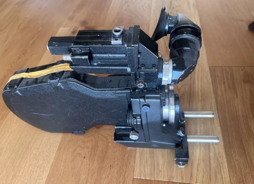

Gerard Dalton Posted October 30, 2024 Posted October 30, 2024 2 hours ago, D John Carroll said: It can be relocated anywhere. The new sensors are extremely small, like 25mm x 2mm, so they can fit into the body anywhere and you can run the sdi and power distribution end of the system out via long flex cables I’ve made them for LTR, XTR, 416, and just run the sdi and power to wherever it’s comfortable the biggest issue is if you have relay R optics, or the old top handle conversion I think I have the top handle conversion. I could send a photo but it basically looks like this but how does this effect the process? How easy is the top handle Video assist to remove?
D John Carroll Posted October 30, 2024 Posted October 30, 2024 I can’t find a foto at the moment, but I have a design for this. it completely clears the handle so you can use it
Gerard Dalton Posted November 1, 2024 Posted November 1, 2024 On 10/30/2024 at 1:00 PM, D John Carroll said: I can’t find a foto at the moment, but I have a design for this. it completely clears the handle so you can use it Ok I’ll send you photos of my camera and handle and modification with a tap I saw on a different camera
