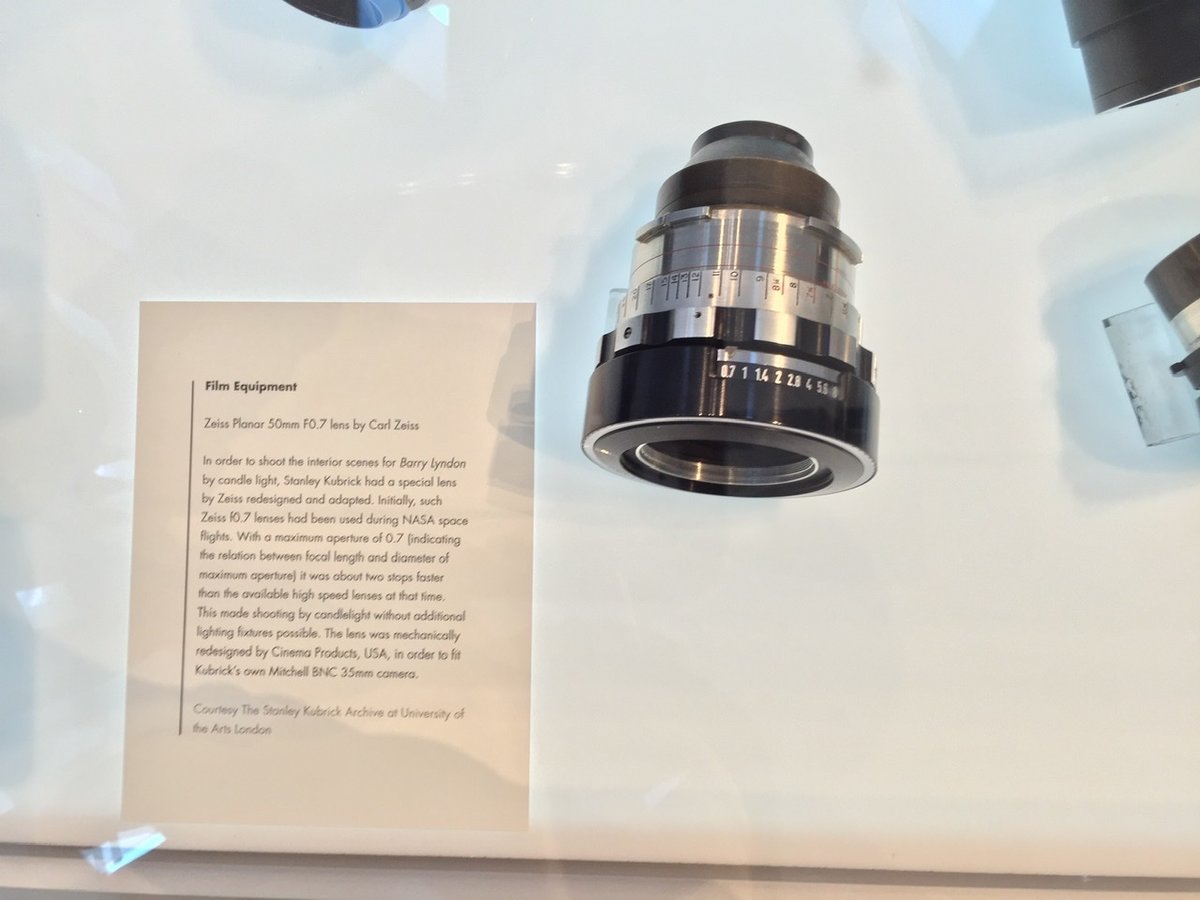

There’s not much in sharp focus at all in most of the famous candlelit ‘Barry Lyndon’ scenes. Everything is right on the edge of being complete mush (in a beautiful way). They are technically in focus, as per Douglas Milsome, who was the focus puller on that film. But the lens doesn’t resolve well at f/0.7 and there is so little depth of field that the actors are always right on the edge of it.
If you’re used to shooting on something like a Leica Noctilux 50mm f/0.95, it may be that part of the reason you perceive a shallower depth of field is that the lens may be focused quite close for portraits. The Zeiss f/0.7 lens doesn’t actually focus that close. Here’s a few photos of the actual lens from the Kubrick Exhibit, you can see the minimum focus is 6’:
Here, Mr. Milsome discusses the technical challenges he had on the film and how he kept it in focus:
