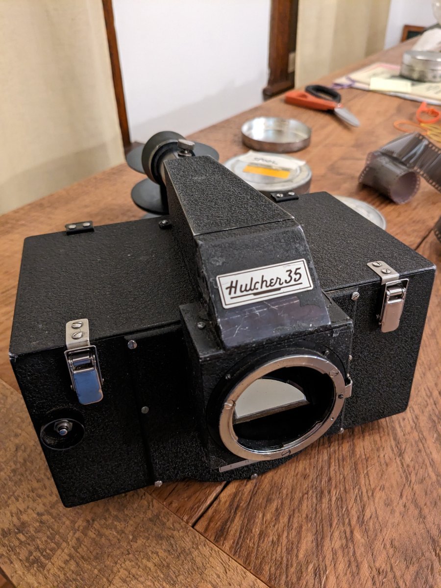

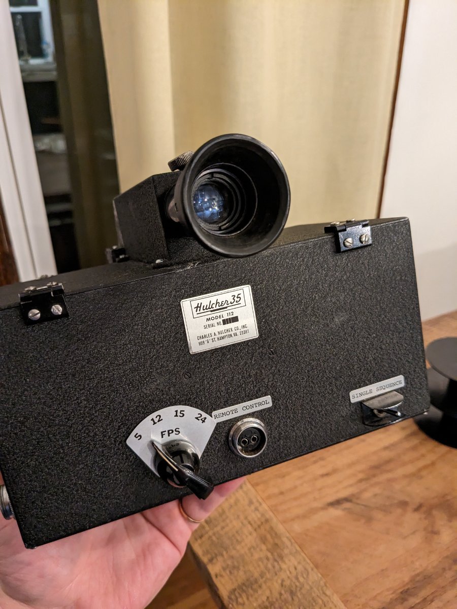

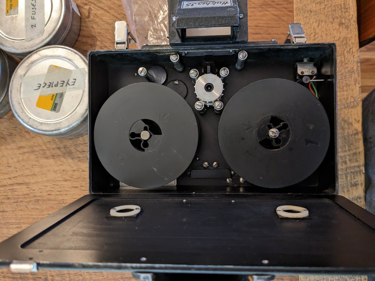

Premium Member Matt Figler Posted November 15, 2025 Premium Member Posted November 15, 2025 (edited) 7 hours ago, Geffen Avraham said: The Hulcher "kitchen mixer" movement may be the key to making quieter film cameras, as it continuously rotates and requires no reciprocating parts. I imagine the image registration is inferior to a Mitchell, but this is irrelevant. If it cannot be fixed with modern servo motor control, then it can easily be remedied by projecting a laser cross fiducial marker onto the unused area of the film negative, for post stabilization. The end result is perfect registration, and quieter running on set. If anyone would like to see the film path, 'beater' pulldown of a Hulcher, here's mine. I'm in slow pursuit of adapting a 400ft mag. I think with modern scan tech, frame to frame registration is less of the issue it once was. The variable shutter is a simple brilliant design, it's two intersecting circles with a pie slice cut out, this particular body goes to 24fps (conveniently). Edited November 15, 2025 by Matt Figler
Geffen Avraham Posted November 15, 2025 Author Posted November 15, 2025 That's a beauty! How does the pressure plate work? Is there a solenoid pressing it down during exposure, or just passive springs?
Premium Member Matt Figler Posted November 16, 2025 Premium Member Posted November 16, 2025 15 hours ago, Geffen Avraham said: That's a beauty! How does the pressure plate work? Is there a solenoid pressing it down during exposure, or just passive springs? It's a basic spring mech, about as complex as a money clip. The mirror is fixed & semi transparent for TTL viewing.
Geffen Avraham Posted November 16, 2025 Author Posted November 16, 2025 (edited) Have you shot anything with this? How is the image registration? How loud is it? Edited November 16, 2025 by Geffen Avraham
Geffen Avraham Posted December 9, 2025 Author Posted December 9, 2025 Hulcher's still-extant website also mentions the ability to install fiducial markers in this camera, which are like little lights projected onto blank areas of the negative. This means that even if registration sucks mechanically, you can make it more stable than an Oxberry with 5 minutes of motion track work in Fusion.
