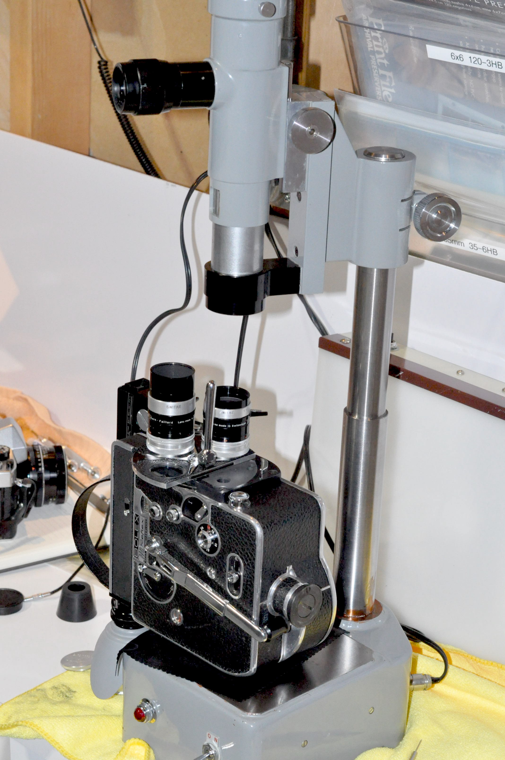

I have a still/film camera autocollimator and found it works very well with my Bolex. With film in the gate it gives a bright clear image of the projected Siemens target .
After cleaning the very tight helicoids on these lenses, they turn very easy now. So easy, the focus collar grabs even with the 3 screws loose. So I found it quicker to just pull it apart, twist the focus ring and then push back together to get the infinity stop just right.
