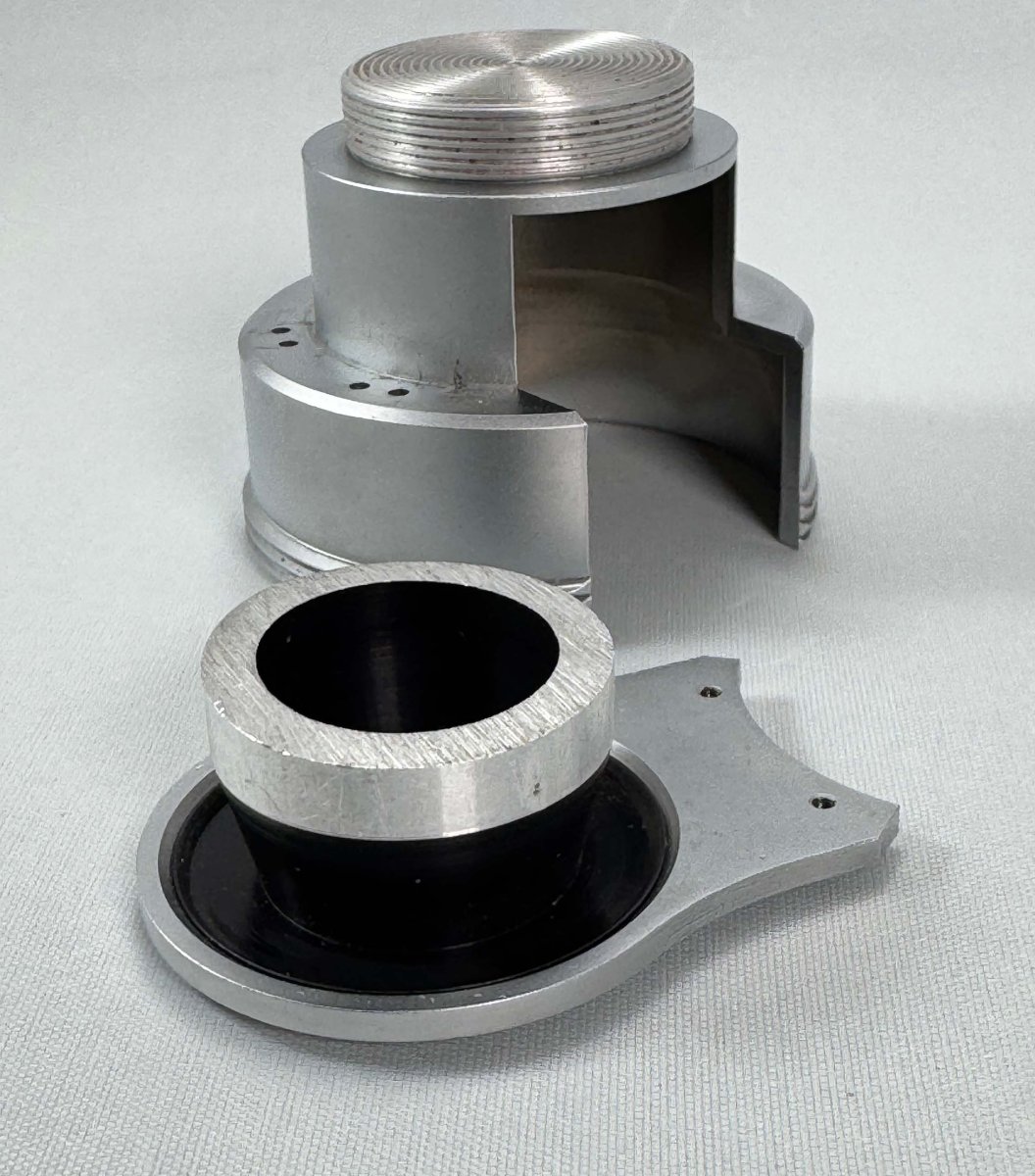

Hello all and Happy belated New Year. I purchased a 12-120mm type A 12-120mm zoom and this was attached with two screws to the c-mount adapter. The rear has a concave shape like its made to fit over something... It seems overkill for just advertising Paillard.
Thanks,
Bob
This is the C mount adapter for dog-leg zooms which have their own reflex viewfinder. I think the other part locates in a second lens mount on a turret Bolex to lock in the orientation.

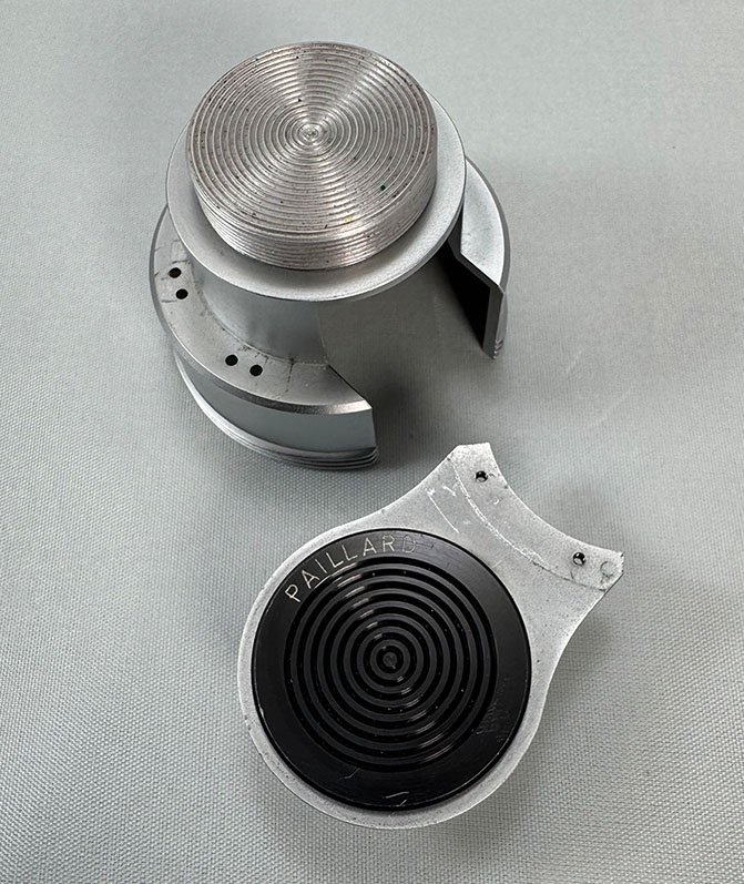

Dom, Thanks - That makes sense. Here is a pick of the other side. I've just never seen one of these before but when I place the adapter on the turret so the finder is in position directly straight down the side, it lines up perfectly over the upper left turret port - not deep enough but maybe a missing item would be a plug for that turret spot.
Appreciate you taking the time! Bob
