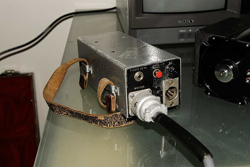

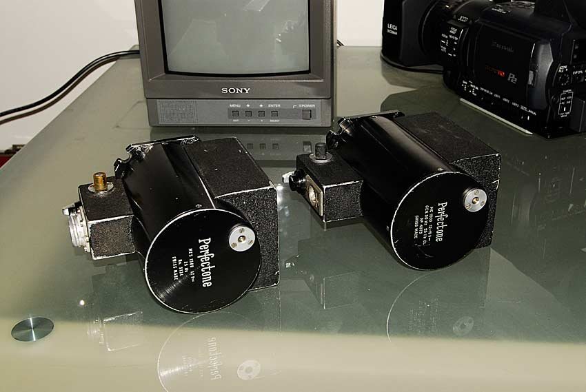

Premium Member Tim Terner Posted March 25, 2008 Author Premium Member Posted March 25, 2008 I've never had the "old perfectone ciblo ' on the camera before Bernhard but put it in yesterday to do your PAL-TV test. There is actually a little yellow lamp that comes on and stays on when running (there also wasn't any interference in the image on the TV). The control box, which is for the other motor, has no markings for 25i/s or 24i/s. Here is better pics of the front and back
