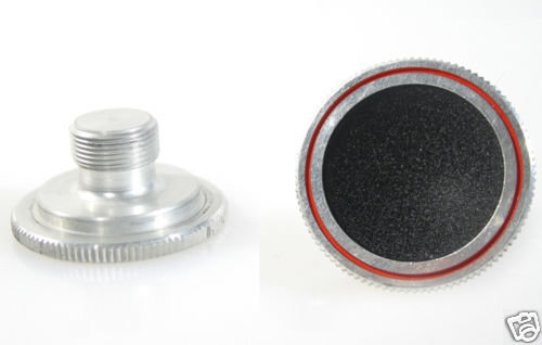

Tim Halloran Posted December 8, 2009 Posted December 8, 2009 (edited) Do the aluminum turret lock screw caps come in different thread sizes? I got one off of ebay but its threaded shaft diameter is too big for the hole behind the turret in my REX1. Any idea about what camera the one I have might go to (in case the seller won't take it back)? Here it is: Thanks in advance. Tim Edited December 8, 2009 by Tim Halloran
Chris Millar Posted December 8, 2009 Posted December 8, 2009 No direct experience here but I'm guessing a H8 / H16 mix up (?)
Jean-Louis Seguin Posted December 8, 2009 Posted December 8, 2009 The cap shown in the picture is for non-reflex cameras and goes in the topmost turret opening. Its thread size is 13mm. The one for RX cameras has a thread of 10mm. Cheers, Jean-Louis
Tim Halloran Posted December 8, 2009 Author Posted December 8, 2009 The cap shown in the picture is for non-reflex cameras and goes in the topmost turret opening.Its thread size is 13mm. The one for RX cameras has a thread of 10mm. Cheers, Jean-Louis Thanks for the information and the assistance! Tim
