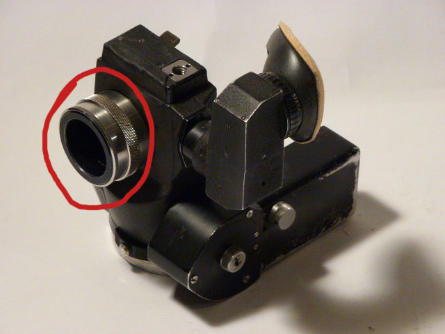

steven feng Posted August 31, 2013 Posted August 31, 2013 Hello,I buy a eclair acl camera .This camera have c and arri mount.I have a c mount lense. But I couldn't get the arri mount to remove. The arri mount adapter is not moved?
Premium Member Gregg MacPherson Posted August 31, 2013 Premium Member Posted August 31, 2013 Hey Steven, You will need to remove the Arri S adapter. Have you fitted and removed these adapters before? The stainless steel ring at the rear is threaded onto the edge of the camera's TS flange, which has the c mount. You should be able to apply quite a lot of torque with your fingers without damaging anything, anticlockwise to undo. If you can't do it, do you have a camera technician you can see?
