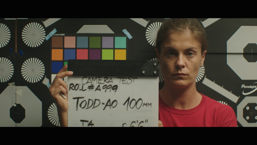

Massimo Proietti Posted October 27, 2015 Posted October 27, 2015 (edited) HelloI own a Set of Todd-ao wonderful ...lenses are really beautiful ..This is a link to a spot made with Todd-ao: Massimo ProiettiTechnical Manager Film Camera and Optical Panalight Spa www.panalight.it https://www.youtube.com/watch?v=ZNdo2inxvys Edited October 27, 2015 by Massimo Proietti
Premium Member David Mullen ASC Posted October 27, 2015 Premium Member Posted October 27, 2015 Clairmont still has their Todd-AO lenses apparently.
Massimo Proietti Posted October 27, 2015 Posted October 27, 2015 (edited) Edited October 27, 2015 by Massimo Proietti
