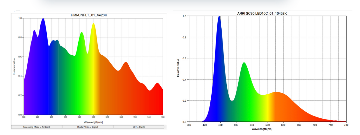

Ruth Vilas Posted June 18, 2025 Posted June 18, 2025 When I try to create a moonlight look with an HMI at 5600K and the camera at 3800-4000K, it looks blue enough. But whenever I try the same with SkyPanels set to 5600K, it doesn’t look nearly as blue. I have to push the SkyPanels up to around 10,000K to get a similar feel or even go to the blue color on HSI mode. Could this be due to the spectral difference, maybe the HMI has more blue content than the SkyPanel? Attaching spectral comparisons for reference.
Premium Member Aapo Lettinen Posted June 18, 2025 Premium Member Posted June 18, 2025 13 minutes ago, Ruth Vilas said: When I try to create a moonlight look with an HMI at 5600K and the camera at 3800-4000K, it looks blue enough. But whenever I try the same with SkyPanels set to 5600K, it doesn’t look nearly as blue. I have to push the SkyPanels up to around 10,000K to get a similar feel or even go to the blue color on HSI mode. Could this be due to the spectral difference, maybe the HMI has more blue content than the SkyPanel? Attaching spectral comparisons for reference. ungelled HMI is usually colder than 5600K, it should be something like 6000K but can be more depending on bulb condition and type etc. The ones I have used have often been a bit colder than 6000, I think they could have been closer to 7000K than 6000
