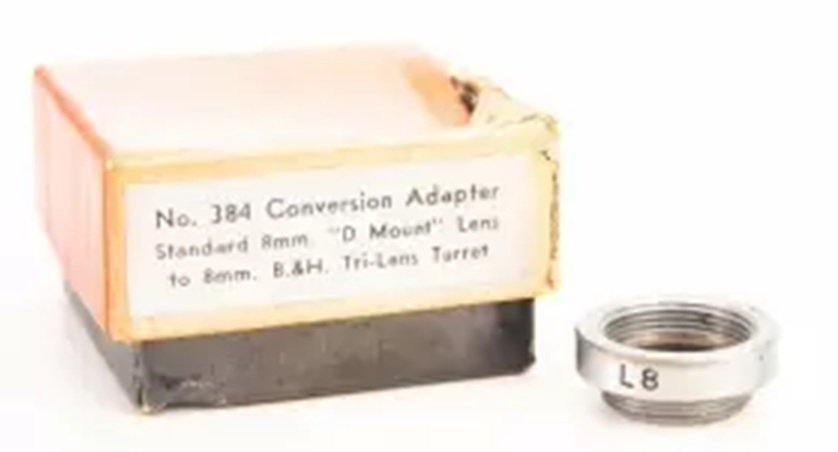

Premium Member Simon Wyss Posted January 16, 2020 Author Premium Member Posted January 16, 2020 The adapter D-mount to 134-Turret is Elgeet nr. 384, like here. Elgeet 386 lets you use C-mount lenses with clip-on Eights. Elgeet 389 serves to put C-mount lenses on a 134 T. 1

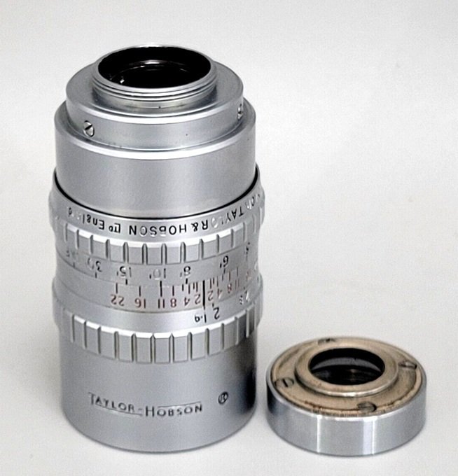

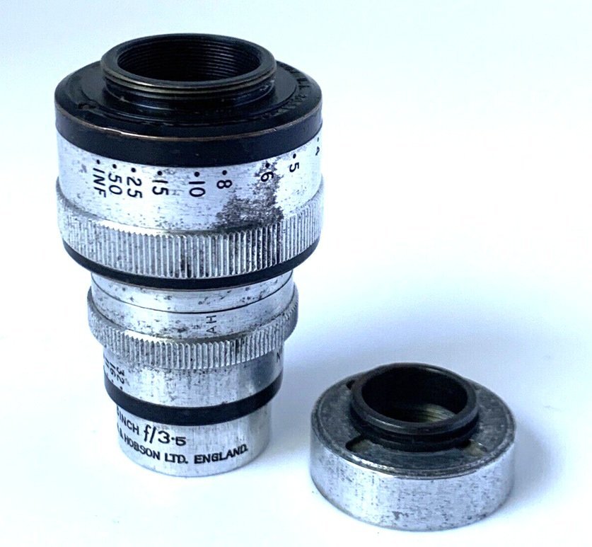

Robert Randall Posted January 16, 2020 Posted January 16, 2020 (edited) Thank you! Forgive my ignorance and lack of specificity. I’m trying to use this lens on my m43 camera for which I have both C and D adapters. This Here They’ve listed it as an rms mount. Is that correct? Edited January 16, 2020 by Robert Randall
Premium Member Simon Wyss Posted January 16, 2020 Author Premium Member Posted January 16, 2020 (edited) Oh, no, that lens lacks an intermediary ring from a special thread* to the 134 turret thread. RMS is metric and Taylor, Taylor & Hobson or the American manufacturer wouldn’t use metric threads. Comat and Super Comat lenses are Cookes which leaves me a bit at loss about the Made in U. S. A. It is a normal lens for 8mm film cameras. May have been Wollensak to sub-treat this. _______________________ * 95/128" or 18,85 mm, 40 t. p. i., 60 degrees flank angle Edited January 16, 2020 by Simon Wyss Thread specifications added 1

Premium Member Simon Wyss Posted January 17, 2020 Author Premium Member Posted January 17, 2020 I have seen Angénieux lenses bearing that ring, Wollensak, and TTH. For your consideration, the Comat is a dialytic four-glass design, the Super Comat has five elements. In a way, big and heavy lenses contradict the Filmo-8 concept.

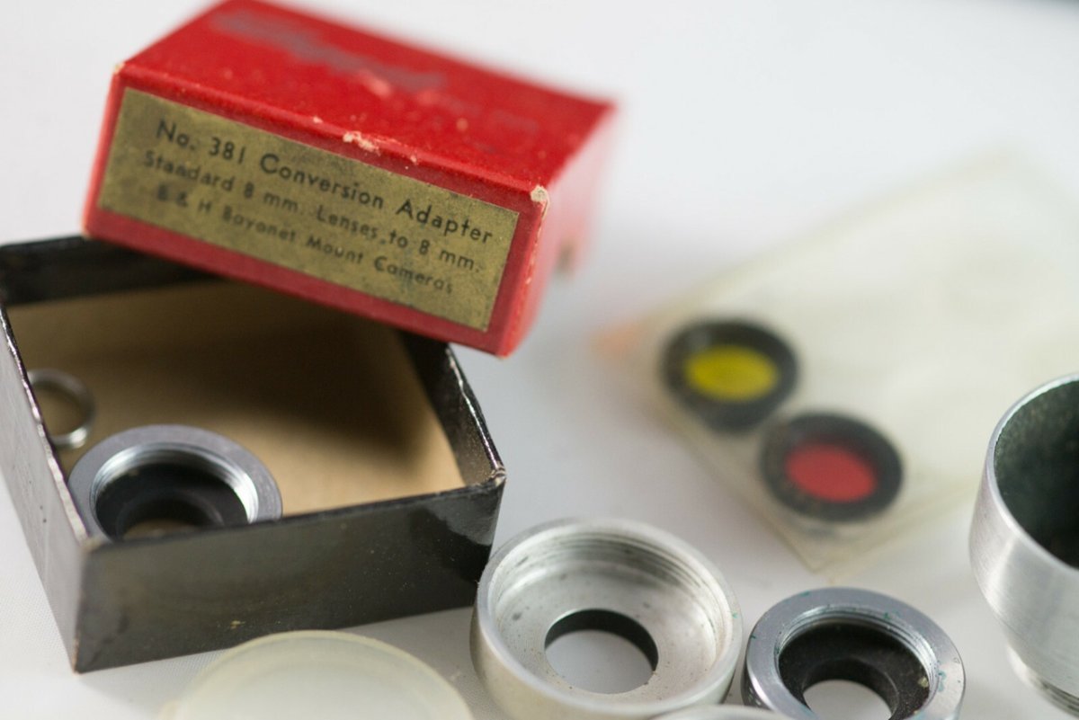

Johnny Liu Posted November 13, 2025 Posted November 13, 2025 Simon, I have been looking for the Elgeet 384 adapter on eBay, but don't think I have found one yet. But, while looking, I found this other adapter called an Elgeet 381. The description on the box says it converts "Standard 8mm lenses to 8mm B&H bayonet mount cameras". When they say "Standard 8mm" do they mean D-Mount? Or do they mean the screw mount specific to older B&H cameras? Also, which B&H 8mm cameras used bayonet mount? https://www.ebay.com/itm/135069858861 Are the below two eBay items also examples of adapters to the Bell and Howell bayonet mount? https://www.ebay.com/itm/185571866247 https://www.ebay.com/itm/297629006489

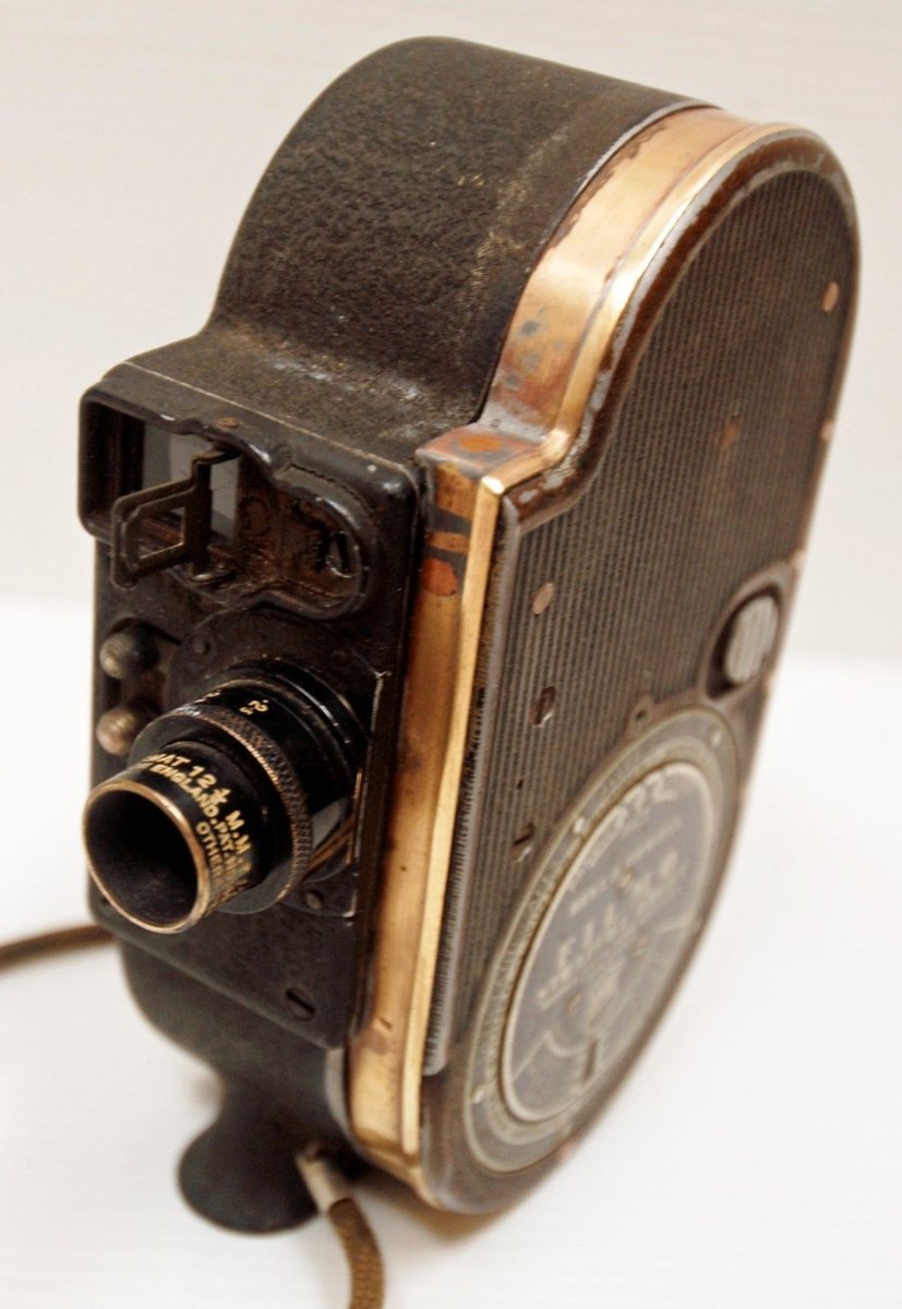

Premium Member Simon Wyss Posted November 14, 2025 Author Premium Member Posted November 14, 2025 Don’t give up early, I am sure you’ll find one. The standard mount for lenses on 8-mm. cameras is the D mount, a thread. The other, finer, thread with that intermediary ring is Bell & Howell specific, used on the Aristocrat turret Filmo Eight. It was there to strengthen B. & H.’s monopoly. The D mount was kind of a soft licence, handed over to camera makers silently (EMEL, Niezoldi & Krämer, Stewart-Warner, Keystone, Paillard). Lens makers offered their products with various mount rears. The first Bell & Howell camera for 8-mm. film was the Filmo Straight Eight, model 127, put on the market in 1935. It features a clip-on or spigot mount. You see it with the other intermediary ring next to the TTH 1.5 inch, f/3.5. The Straight was soon paralleled by the Filmo Dual Run 134 models until the Straight had to be abandoned within a year. Dual Run Filmo also had the lens bayonet. Filmo 70 cameras for 16-mm. film all have C mount threads. Eyemo 71 bear a lens bayonet. And yes, there were an A and a B mount on the early Filmo 70. These afford centering of lenses to the aperture. Clip-on mounts locate a lens repeatedly in the same position. Threads don’t.

Premium Member Simon Wyss Posted December 12, 2025 Author Premium Member Posted December 12, 2025 Johnny, have you asked there? https://camlensadapter.com/no-384
Johnny Liu Posted December 16, 2025 Posted December 16, 2025 Simon, no I have never seen that website before. But, it looks great! Thanks for the tip!

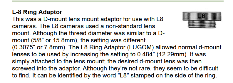

Johnny Liu Posted December 16, 2025 Posted December 16, 2025 Simon, In the webpage you gave me a link for, they have a picture of the Elgeet 384 adapter and the box it came in: The adapter is stamped "L8" and it looks very similar to an adapter that was used for Bolexes to allow a D-Mount lens to be used on the older Bolex L8 cameras. It is described here on this webpage: http://www.bolexcollector.com/accessories/filter50.html Do you know if the Elgeet 384 adapter is the same as the above Bolex L8 adapter? If so, that is great because I already own two of these Bolex L8 adapters!
