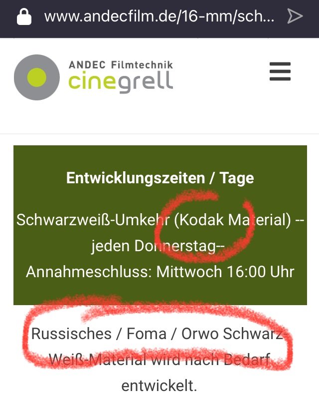

Joerg Polzfusz Posted May 17, 2024 Posted May 17, 2024 Hi Mark, 1/40 s at 24fps makes sense as the shutter seems to have a 207° opening. No offense regarding the light meter. I only noticed that the production of the camera started before the „ASA update“. Hence, you might have used a light meter that came with the camera and that is as old as or even older than the camera. Does anyone know the differences in developing B&W reversal? At least Andec is processing the Kodak-reversal filmstocks separately from Foma/ORWO/Russian stocks. When the lab has mistaken your Kodak-film with ORWO-film, it might be a problem caused by them… (But that’s just a wild guess. I have not got any clue about developing.)
