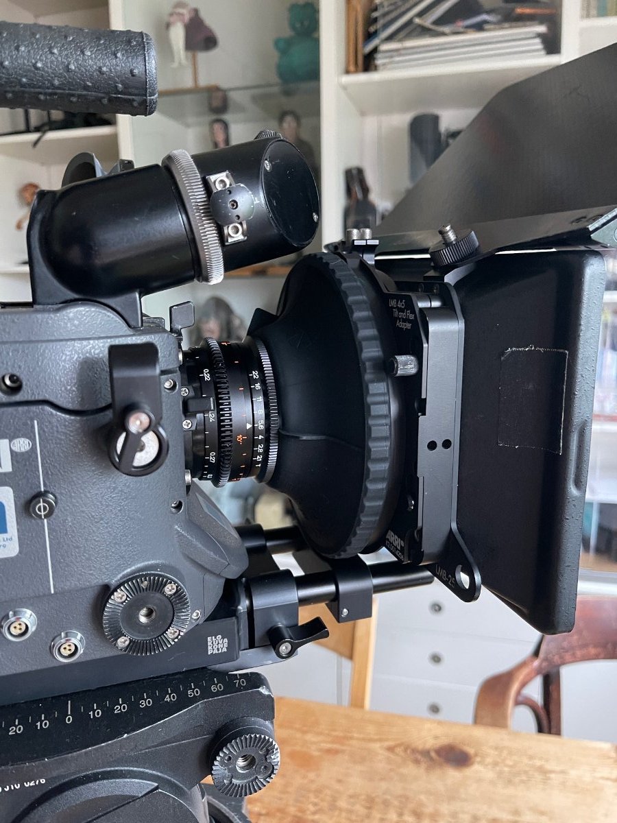

Premium Member Uli Meyer Posted June 27, 2024 Premium Member Posted June 27, 2024 Clip-on matte boxes will eventually wear out your focus threads. 15mm mounting is the way to go. You will need a rubber donut for the zoom lens but I don't think the one you have will fit any of the options you mention. Smallrig offers a silicon donut for theirs and Wooden Camera zip box pro with 15mm swing away support offers a cloth one. I'm using an ARRI LMB-25 with an LMB 4x5 tilt and flex adapter and LMB lightweight rod adapter for 15mm rods for my vintage lenses. 1
