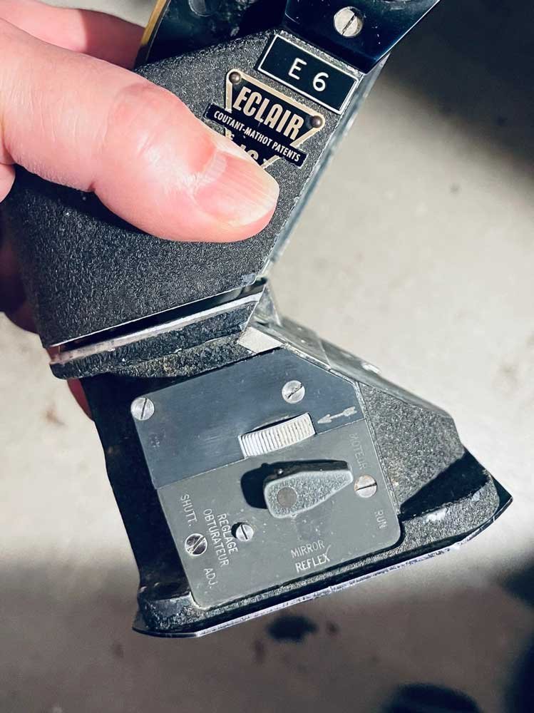

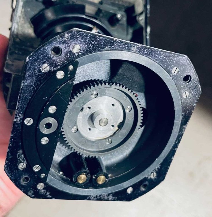

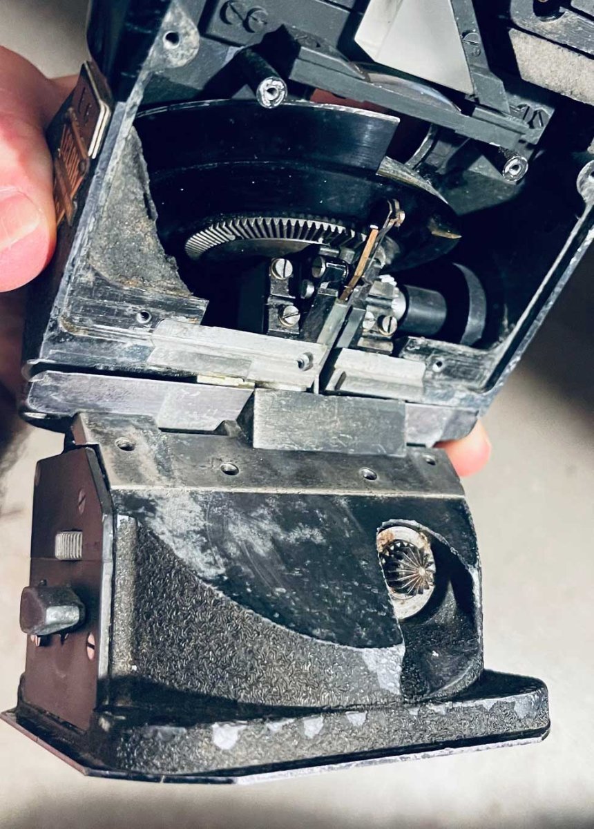

adrian wolfson Posted April 30 Posted April 30 Does anyone here have a service manual for an NPR. I got a unit that needs a lot of TLC to fix and need to take the whole thing apart and not sure how to remove the bottom section with the gearing from the main housing. Thanks
