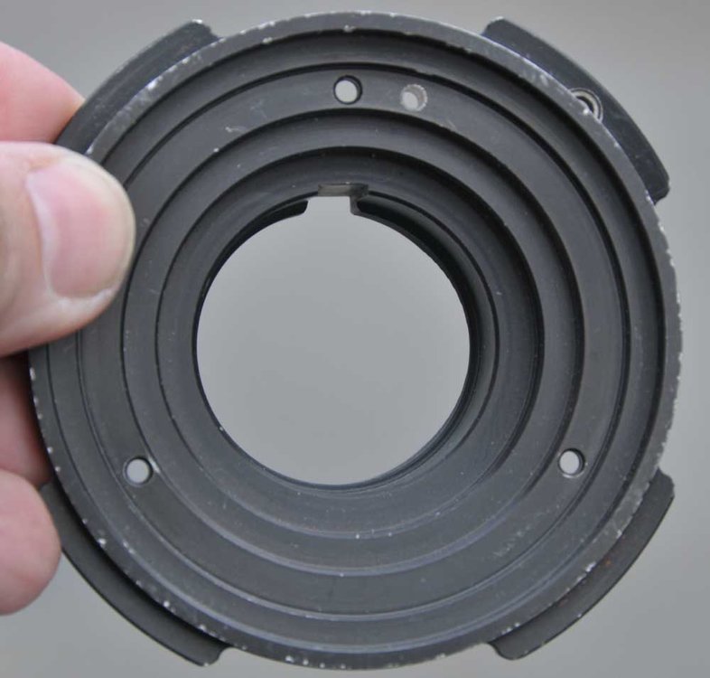

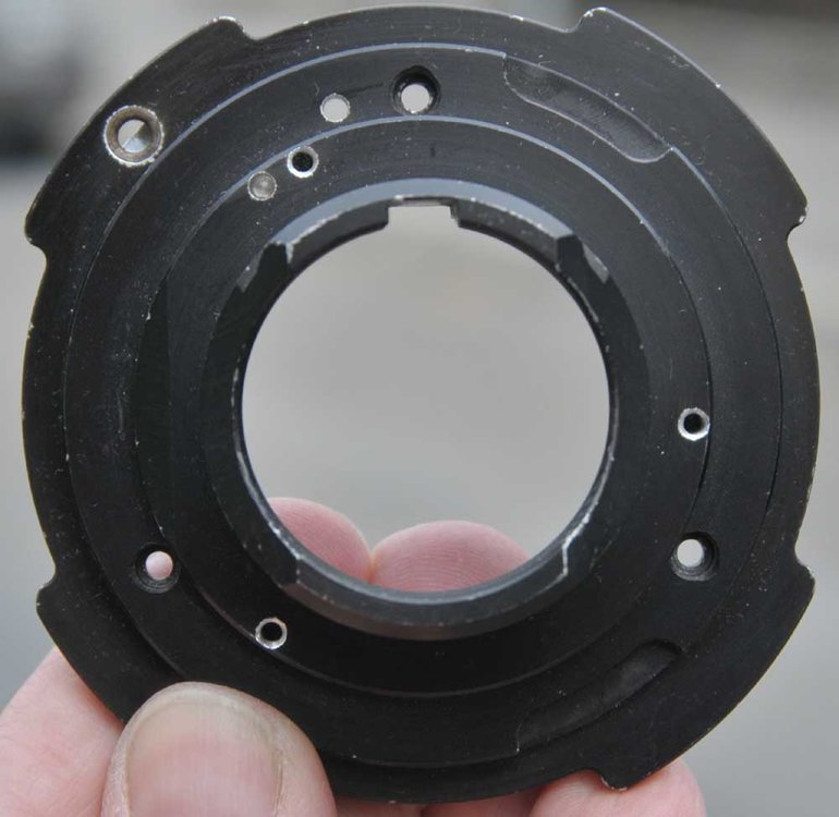

Premium Member Stephen Williams Posted May 5, 2009 Premium Member Posted May 5, 2009 IIRC, the older Standard lenses would work in the newer Steel Bayonet socket. For a while, the II-C's were shipped with one SB and two standard ports. If I'm remembering that right, it seems likely that an SB to BNCR adapter would do everything you want. Flange focal distance requirements might force things to be a bit cramped, though. -- J.S. Hi John, Looks like the mount adapter I have is Bayo, it's lightweight & not steel. I am not sure if it will work or not, what do you think? Best, Stephen
Premium Member Tim Carroll Posted May 5, 2009 Premium Member Posted May 5, 2009 Stephen, Now that is one truly strange adapter. I don't know the BNCR mount that well, but I'm rather familiar with the ARRI. That piece you have has an ARRI standard mount on one end, and what looks like a BNC mount on the other. But (again not really knowing the BNC mounts) they both look to be male mounts. I can't imagine what that adapter is used for. The ARRI standard mount on there would fit right into an ARRI standard mount turret on a camera, and the BNC mount looks like it would fit right into a BNC mount of a camera, so then you would have the two cameras facing each other. Then what would you do? I could be totally missing something, but I can't understand how that adapter works at all. Best, -Tim PS: I just realized what that mount could be used for. Maybe it is a lens mount, not a mount adapter, and if you mount that mount on a lens, then you could use that lens on both a camera with a BNC mount and on a camera with an ARRI standard mount. So it is a lens mount that is designed to fit on two different camera mounts. Just a thought.
Premium Member Dan Goulder Posted May 5, 2009 Premium Member Posted May 5, 2009 Hi John, Looks like the mount adapter I have is Bayo, it's lightweight & not steel. I am not sure if it will work or not, what do you think? Best, Stephen Ah... yes... It's the mystery mount/adaptor/whatnot. I've got one also. Nobody has any idea what this piece is used for... not the guy I got it from, or the lens technicians I've shown it to. Does anyone out there have any idea what this thing is, and what it's made for? (No guesses, please, as I've heard them all.)
Premium Member Hal Smith Posted May 5, 2009 Premium Member Posted May 5, 2009 Now that is one truly strange adapter. I don't know the BNCR mount that well, but I'm rather familiar with the ARRI. ............. Maybe it is a lens mount, not a mount adapter, and if you mount that mount on a lens, then you could use that lens on both a camera with a BNC mount and on a camera with an ARRI standard mount. Well, whatever it is, it isn't extremely rare. There was one on ebay recently, Stephen has one, and I've got one. Mine came from England with an assortment of Arri odds and ends I bought off ebay a couple of years ago.
Premium Member Tim Carroll Posted May 5, 2009 Premium Member Posted May 5, 2009 The more I look at it the more I believe it is a lens mount. Guessing at the distance between what would be the flange when mounted on a BNC mount camera and the flange when mounted on an ARRI standard mount camera, looks to be the same dimension you would get if you subtracted the ARRI FFD from the BNC FFD. That and then when you see the three mounting holes. Since Stephen is saying it is made out of a lightweight material (guessing aluminum) which would not be terribly stable for a lens mount, maybe they were not used much. And realize that the BNC and ARRI standard mounts were popular 50, 60 70 years ago. So these things could have been made at one time to cover a need of switching lenses between BNC mount and ARRI standard mount cameras (pretty much all that was available at that time) but they didn't work terribly well, so they got taken off and now they're just floating around on eBay and in old camera kit. And all the folks who knew about them are long ago retired or expired. That's my story and I'm stickin' with it! Best, -Tim
Premium Member Stephen Williams Posted May 5, 2009 Premium Member Posted May 5, 2009 Well, whatever it is, it isn't extremely rare. There was one on ebay recently, Stephen has one, and I've got one. Mine came from England with an assortment of Arri odds and ends I bought off ebay a couple of years ago. There were 4 with my first Ultracam package!
Premium Member John Sprung Posted May 5, 2009 Premium Member Posted May 5, 2009 I think Tim has the right idea. It was probably used with fairly long lenses. Rental houses wouldn't want to stock separate ones for both cameras. The extra metal wouldn't be in the way. Back focal distance not all that critical.... -- J.S.
Premium Member Hal Smith Posted May 5, 2009 Premium Member Posted May 5, 2009 The more I look at it the more I believe it is a lens mount. Guessing at the distance between what would be the flange when mounted on a BNC mount camera and the flange when mounted on an ARRI standard mount camera. You might be onto something. I've got a Angenieux 20-120 in BNC out in the shop (it's off Roderick Steven's Ultracam that I believe Steven now has) . I always assumed my adapter was missing the locking collar to use as a BNC adapter but didn't think about its use being to be bolted to the lens itself. I'll try your idea next weekend (I'm headed out of town tomorrow AM and still need to organize for the job). Obviously being Arri standard and made out of aluminum it needs a rod system that fully supports any heavy lens...like my 20-120 cannon.
Premium Member Tim Carroll Posted May 5, 2009 Premium Member Posted May 5, 2009 And the way those two bevels are cut in the ARRI standard mount, that is not needed for any ARRI camera with a standard mount, so I suspect it is for clearance on BNC mount cameras. Making me believe it was "permanently" attached to the lens and designed to work with cameras with either mount. There's one on eBay right now: Mount like Stephen's on eBay Not in as nice shape as Stephen's though. Best, -Tim
