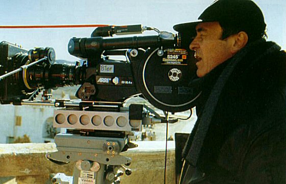

Premium Member David Mullen ASC Posted February 26, 2005 Premium Member Posted February 26, 2005 He likes zooms actually and uses the Technovision spherical zoom quite a bit. I don't know how he rates his stocks; I'm just saying that the image looks fairly rich like he's printing at some decent lights.
Michael Most Posted February 26, 2005 Posted February 26, 2005 He likes zooms actually and uses the Technovision spherical zoom quite a bit. That's true. In fact, I don't recall ever seeing a prime lens on the camera during "Exorcist" when the camera was on a dolly.
Premium Member Max Jacoby Posted February 26, 2005 Premium Member Posted February 26, 2005 Can someone comment on whether or not my assumption is correct that he utilized the older Cookes for the majority of his earlier work, pre dating and including Last Tango? Did he use re-housed Cookes for later shoots? Indeed he did. Both the spherical and anamorphic Cooke S3s (rehoused by Technovision). Since the quality of these lens series (especially the anamorphic ones) varies from lens to lens, it is important to test to find the really good ones (contrast, sharpness, etc.). Well at Technovision in Rome there is a locker with the best of these lenses, reserved especially for Storaro. They do not get rented out to anybody else.
Premium Member Max Jacoby Posted February 26, 2005 Premium Member Posted February 26, 2005 Hey All, Does anyone know Vittorio Storaros lens choices ( i.e. brand) for his 1.85: 1 pictures, mostly shot in the 80's/90's, such as The Sheltering Sky, Tucker, Reds ( I believe this was a 1.85 picture), and Dick Tracy? Storaro used these Technovision Cooke lenses for pretty much all his movies, including 'Apocalypse Now', 'Reds', 'The Last Emperor', 'Dick Tracy', 'Little Buddha' and 'Bulworth'.
Premium Member Max Jacoby Posted February 26, 2005 Premium Member Posted February 26, 2005 He likes zooms actually and uses the Technovision spherical zoom quite a bit. Do you know which Techno-Cooke Zooms in particular? There are several of these Cooke Zooms that have been adapted by Technovision. They vary from regular Cooke Zooms int hat they are faster, but have slightly less good minimum focus.
