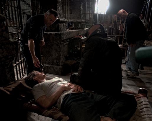

Some of this comes under the category of 'perspective', such as the following...
Through the 'viewing window'...
When viewed from the side...

Thanks guys for all the comments. I have a better understanding now. Yeah I believe now it all has to do with the angle and camera settings of the production photographer/videographer. Thanks Kenny for that reference on color theory.
the-dark-knight-rises-tom-hardy-bane-chr
I'm always at a bit of a loss as to why on set stills people so rarely ask me what my exposure settings are. So I often go out of my way to tell them the settings to use (adjusting the aperture to compensate for a 100/sec photo-friendly shutter). Even more oddly, I find I often have to tell them where to put their cameras in order to catch the light we've just spent 30-45 minutes setting up (surprise surprise - it's on the same angle as our motion camera).
It's one of the reliefs of shooting 4K these days IMO - you know that the producer will be able to pull useful stills from the motion images for marketing.
