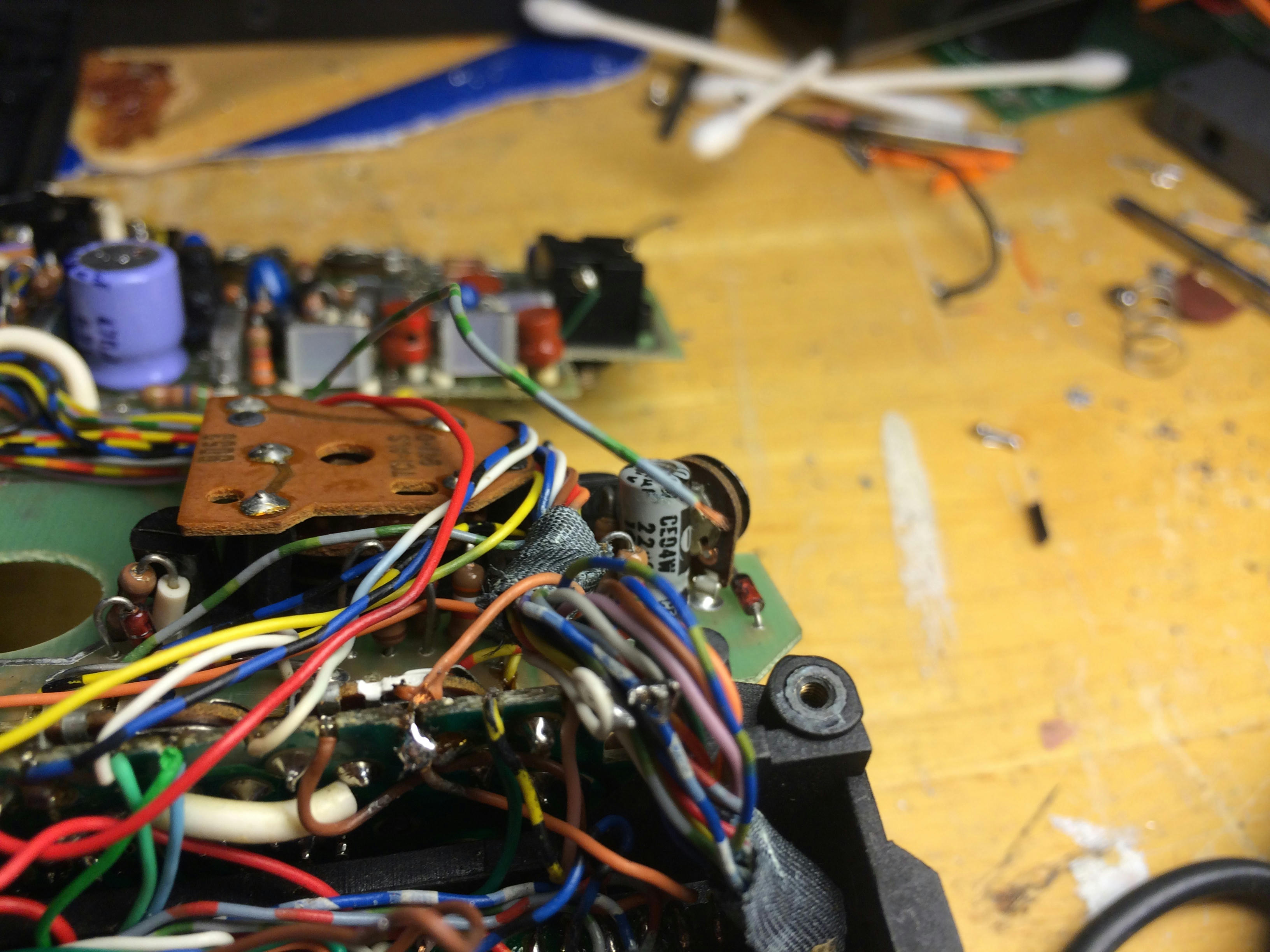

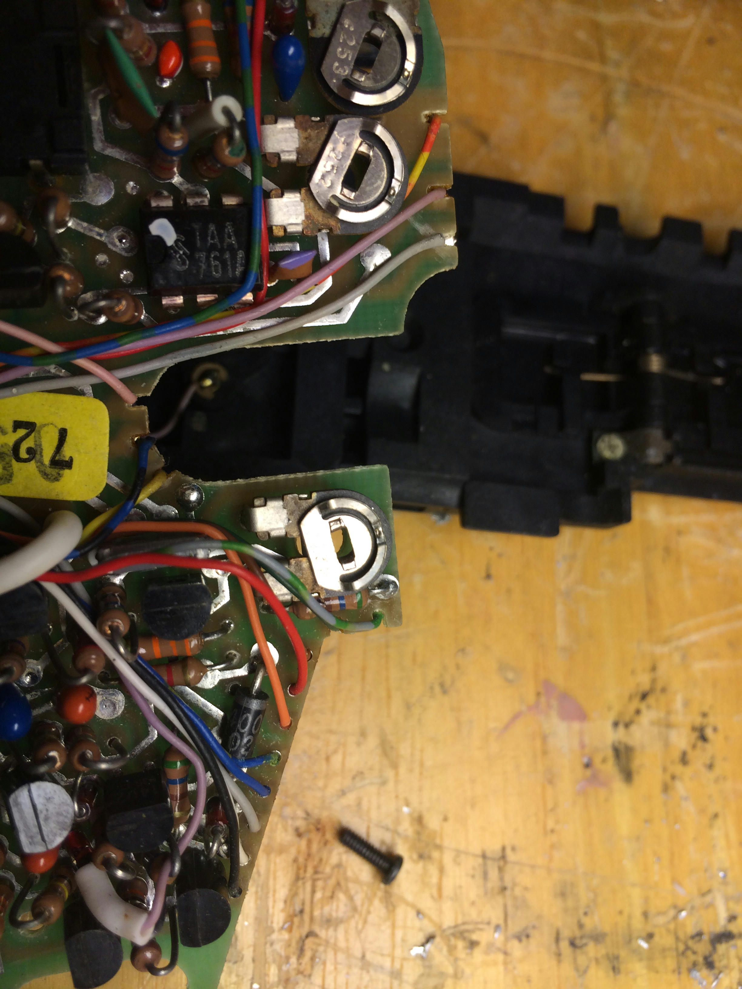

Avery Grade Posted March 7, 2015 Posted March 7, 2015 Hello, recently I bought a Bauer s 207 xl from eBay in unknown condition and long behold it was the victim of battery acid leakage. Unfortunately during me repairing the thing two darn wires broke, found where the first orange wire goes but this gray and green wire has me confounded and looking for answers. So here is all I know it is the close vicinity to the batt. test switch and then goes to a pot and a resister. But tracing it out and even ohming it out did not turn anything up. So this is where I'm at ether I need a service manual or if any one has this camera, to tell me where this wire goes. I will include pictures in the two media fire direct links for what the wire looks like and where it comes from. Help will be appreciated, signed Avery first time super 8 shooter. http://www.mediafire.com/convkey/98d0/ibaq29ht766idzrzg.jpg?size_id=e what the wire looks like http://www.mediafire.com/convkey/f1f6/0hiuuizfbed9ijhzg.jpg where it comes from (Sorry if these are not clickable links I am doing this from an iPad)
Avery Grade Posted March 11, 2015 Author Posted March 11, 2015 Well took a chance and found where it went so don't really need the help on that front. But there is one thing, how do you fool a super 8 cam to think it has a cart in it?
