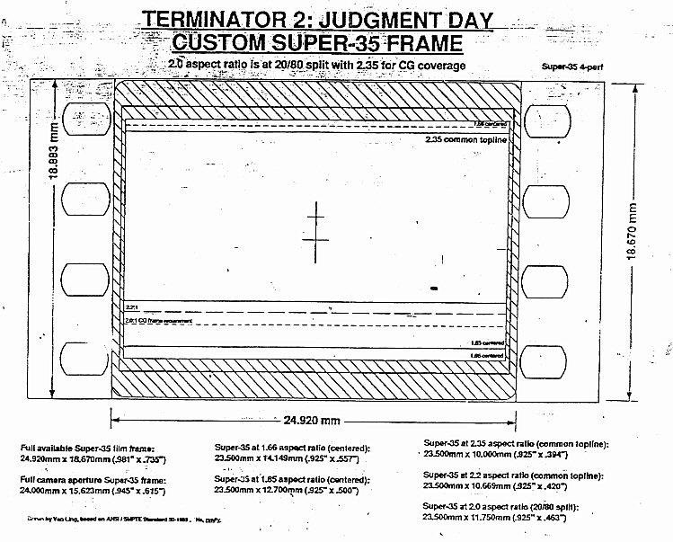

Cameron came up with a variation of common topline for "Terminator 2" which is more like a "T" shape, with the 2.35 being higher than centered but still slightly lower at the top than Full Aperture. You just have to make sure you shoot a framing chart for whoever is doing the conversion to 2.35 anamorphic.
Here's a framing guide for the groundglass installed for "T2" from Otto Nemenz. First thing you'll note is that the cameras (at least A-camera) was given a hard matte to reduce the area exposed from 1.33 : 1 to 1.54 : 1, something that early Super-35 films did before they got comfortable with the idea of exposing all of the 4-perf area for a 2.35 extraction.
You'll also note that CGI shots were delivered with a 2.00 : 1 matte.
