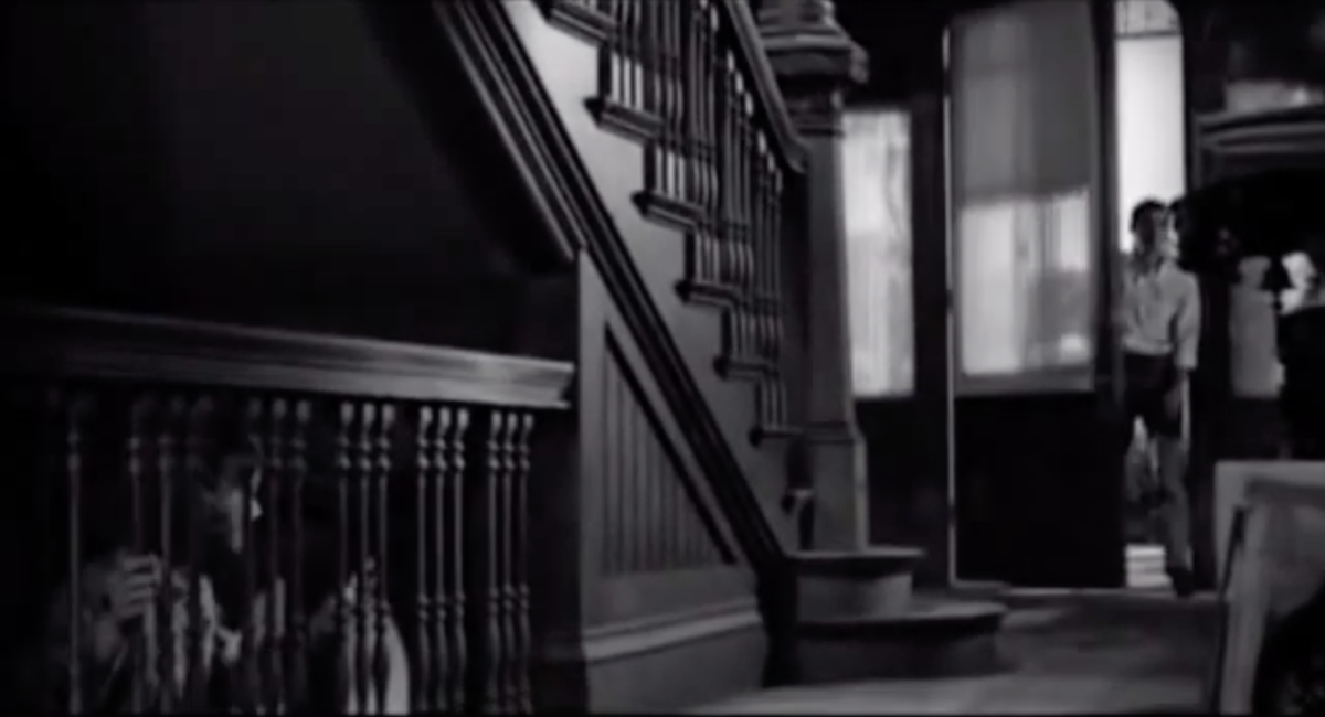

Premium Member David Mullen ASC Posted April 9, 2019 Premium Member Posted April 9, 2019 Grabbed a fuzzy frame from YouTube, but to me, this feels more like a 35mm than a 50mm...
