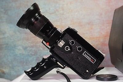

Shane C Collins Posted December 20, 2019 Posted December 20, 2019 (edited) May I suggest the Elmo Super 110. Made in the early 70's. It has both automatic and manual controls. I have this camera and have been very pleased with it's performance, and sharp lens. It's one of the quietest cameras you will ever run. It will recognize all the modern reversal and negative stocks on the market today. Here's a link for the camera's spec. I'm also including a photo of the camera. Please note: The camera only uses 4 X AA batteries. There is no separate battery for the light meter, even though the link says so below. https://www.filmkorn.org/super8data/database/cameras_list/cameras_honeywell_elmo/honeywell_elmo_super_110.htm Edited December 20, 2019 by Shane C Collins
