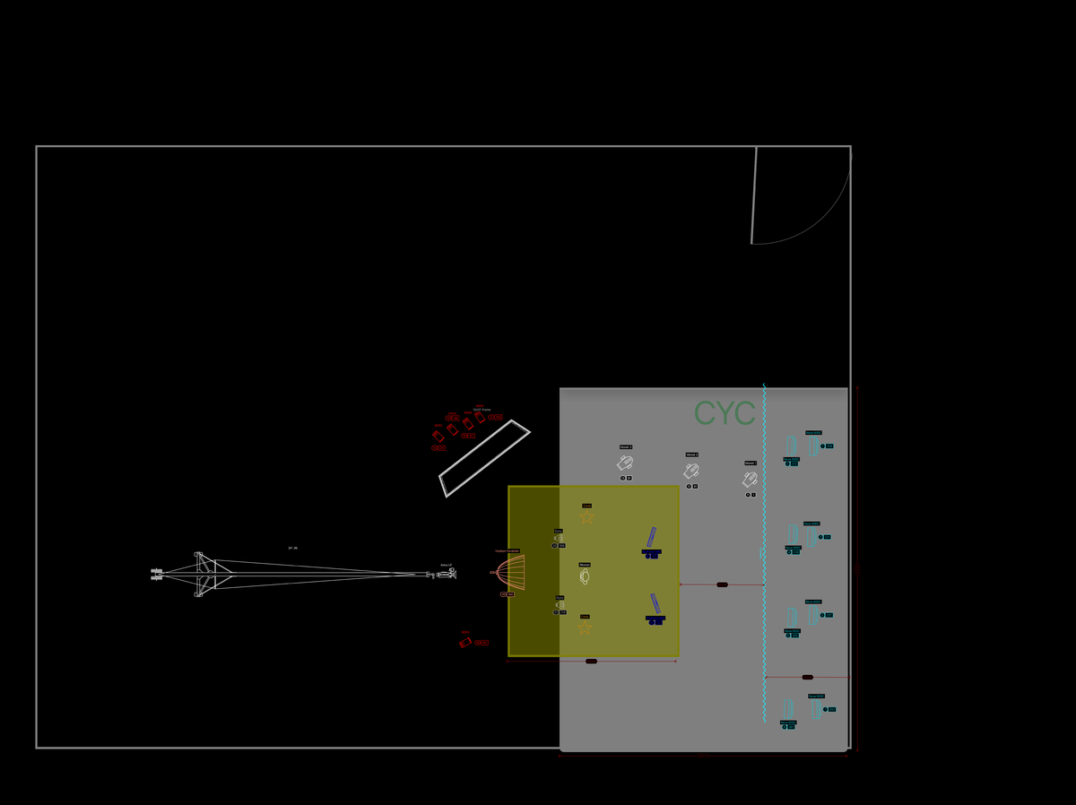

Premium Member Adrian Sierkowski Posted September 7, 2022 Author Premium Member Posted September 7, 2022 (edited) Better safety nets and cheeses. Very important. Looks like we are going with Elation Monets for the FX. I messed around in Capture (not that I know what I'm doing) and the highers liked the look. notoplight1.mp4 And this is the very prelim lighting plot: (some things will probably change). Like loosing the Dynos for a 1200D through a 20x20 top that stills is providing for their work/ budget. Edited September 7, 2022 by Adrian Sierkowski

Premium Member Adrian Sierkowski Posted December 6, 2022 Author Premium Member Posted December 6, 2022 We actually had it, but the output wasn't nearly enough for our shoot.. We wound up going with elation artise Monet's and Picassos which worked well but even then wasn't really as bright as we would like.
