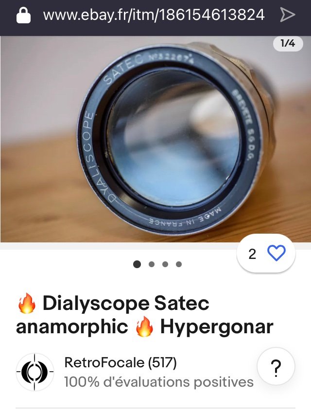

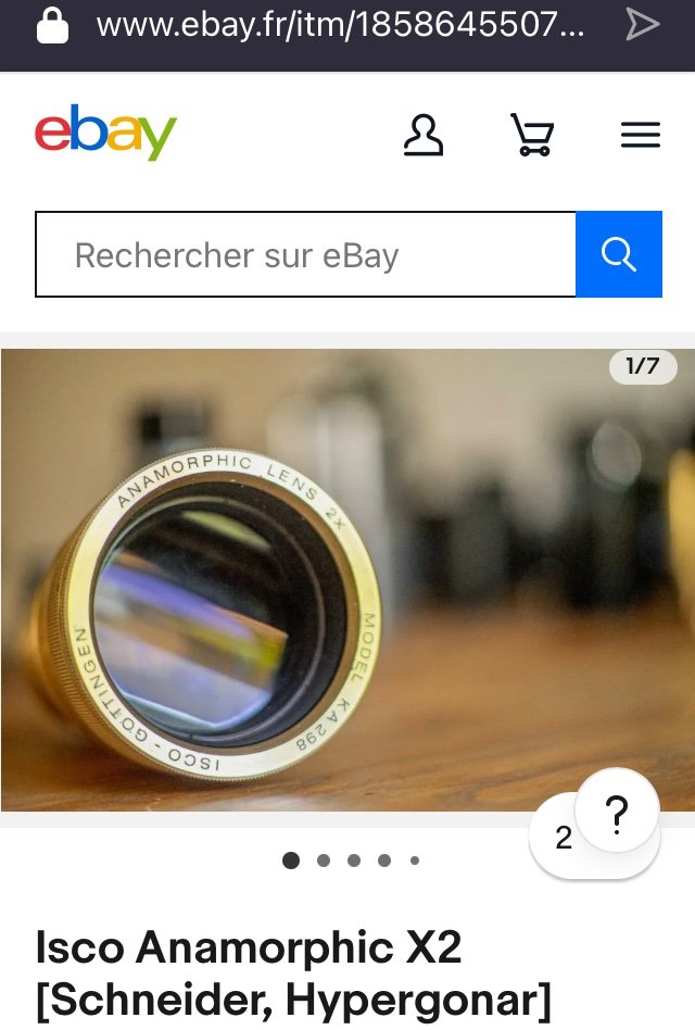

Joerg Polzfusz Posted May 18, 2024 Posted May 18, 2024 Some current auctions on eBay.fr where the term „Hypergonar“ is incorrectly used for anamorphics from competing companies…

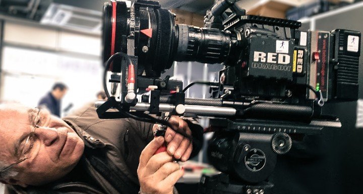

Edith blazek Posted June 22 Author Posted June 22 (edited) Reviving the thread, does anyone know of the construction of the scope itself like what parts are used? Here, it's pictured on an angenieux/tokina 28-70 Edited June 22 by Edith blazek
